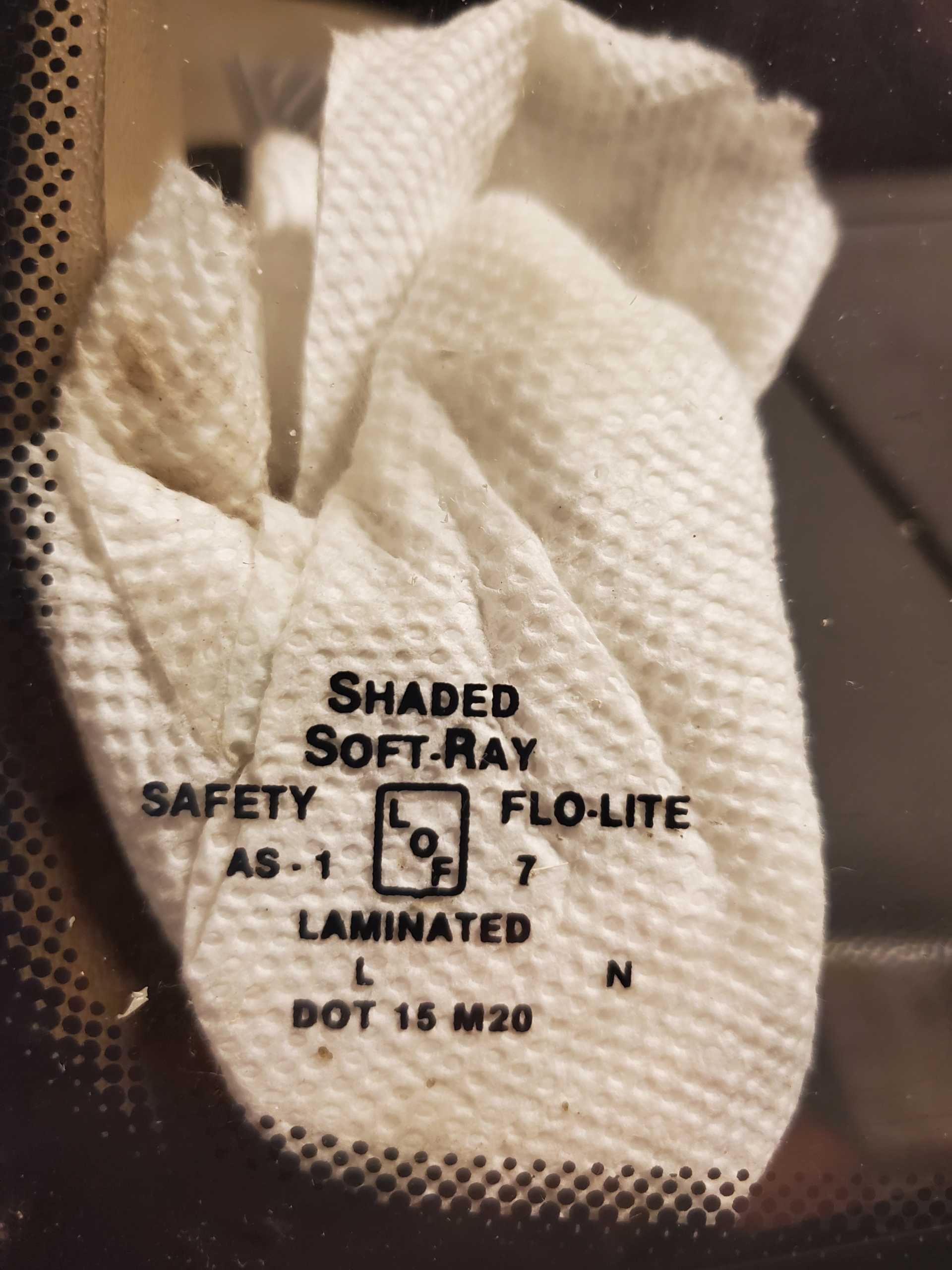

I'm trying to keep the car as original as feasible.
I reached out to Richard @ Prosource last year but the inventory they had was disposed of.
This is from the glass currently in the car, unfortunately its been cracked across the top pretty good. If I get a pic of the grey glass I'll post it.

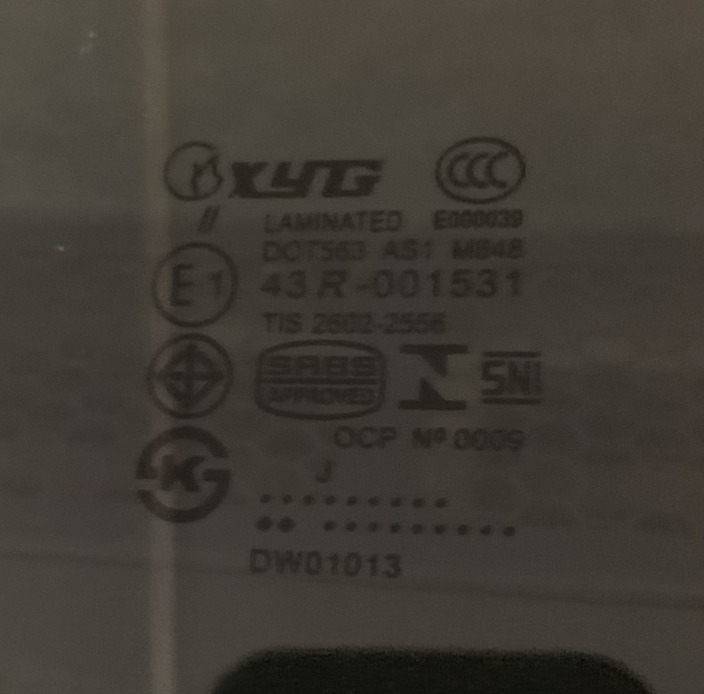

Got mine replaced by Safelite in the last month or two. They told me the only tinted ones available are blue. I was concerned because I have charcoal grey tinted windows, but it actually blends in fine. I really don't think it looks blue, but that's what they say it is.
