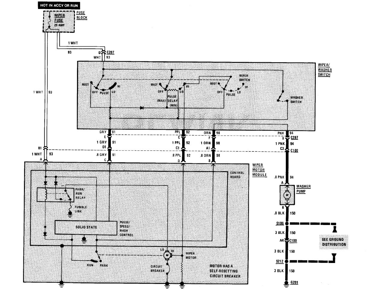

i just got this car a few weeks ago and im having a problem with the washer pump. i have 0 volts going to the pump whenever i twist the wiper stick put the wipers move. i have already replaced the relay for the pump but that made no change. does anyone know the fix for this problem?

There is no relay. Has to be wiring or the wiper/washer/cruise stalk.

theogre NOV 20, 08:06 PM
Yes, no relay w/ and w/o delay wiper.
column switch runs pump on cars w/o delay wiper
85-88 Delay Board in Wiper motor and column switch runs pump on cars w/ delay shown above.
