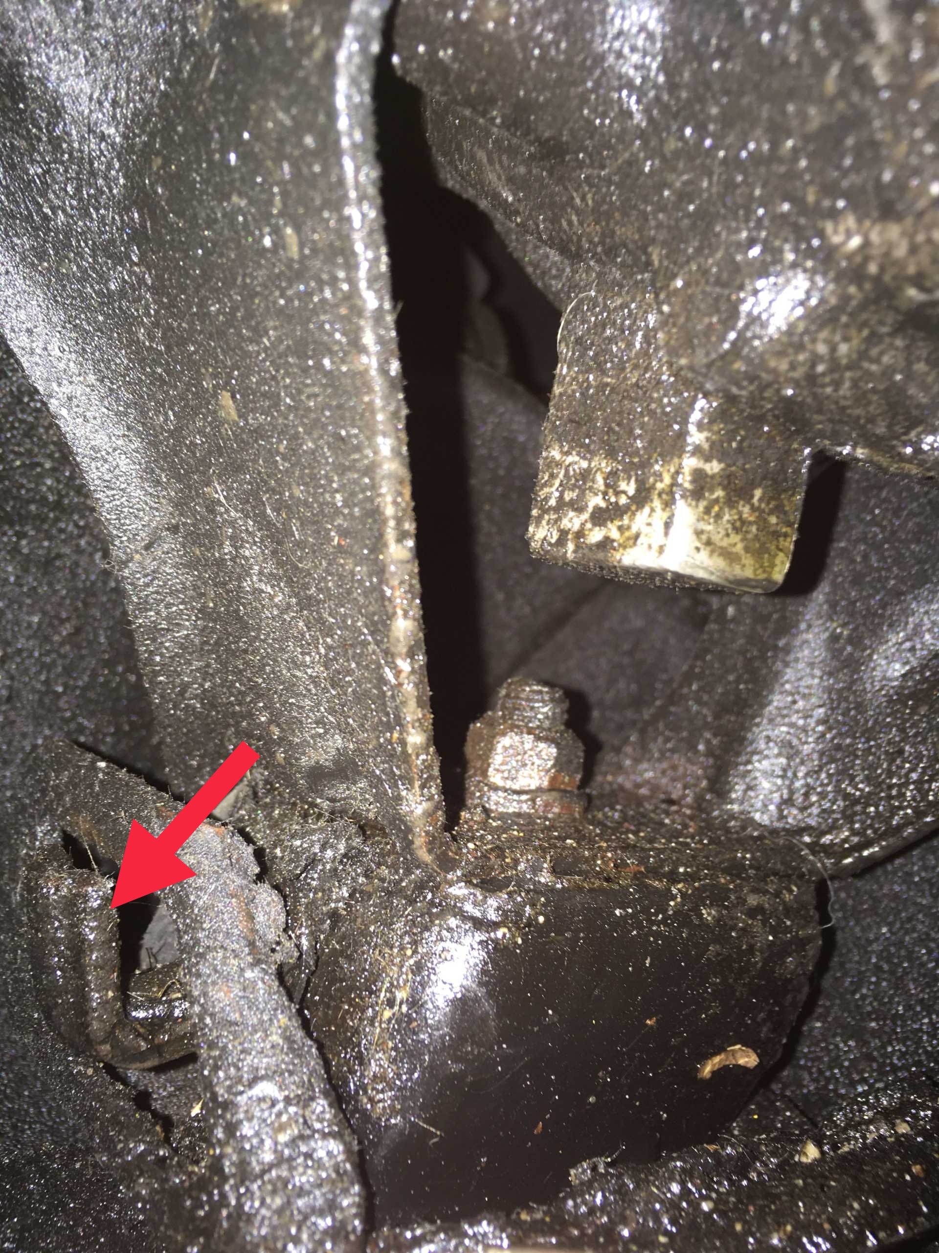

Excuse my filthy car, but is this transmission mount collapsed? It seems to me like that tab should be towards the top of the hole, not the bottom. Any advice?

If you are talking about this tab
It hooks the metal above if the mount fails. If that's what you are talking about it looks fine

I am currently working on mine and that is the way it looks.
