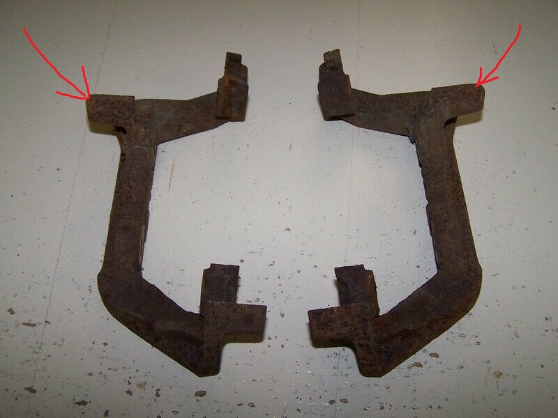

In the Fiero front, steering stops are included in the brake caliper brackets:
So the steering stop function is already handled by the feature on the brake caliper bracket, in the 84-87 Fiero.

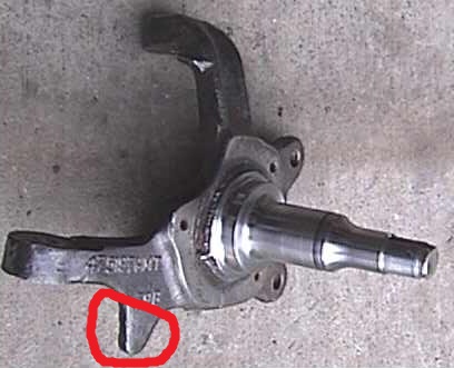

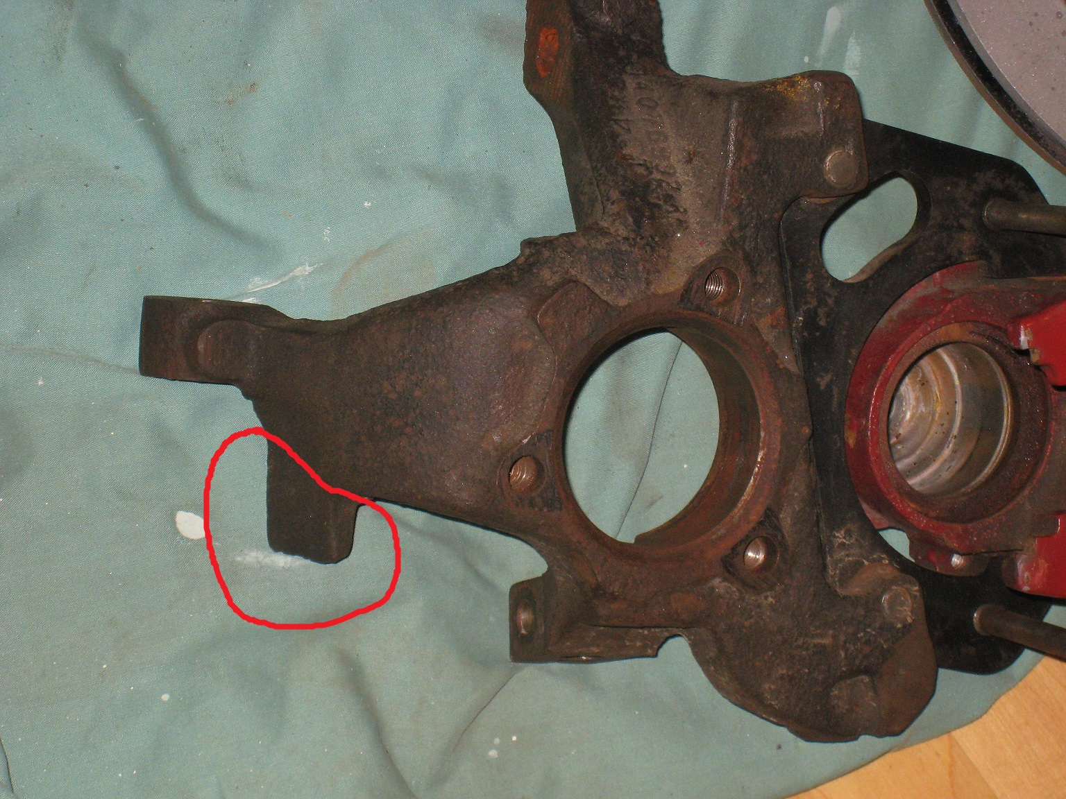

I found a photo of a front knuckle on PFF, and I circled the front knuckle bump:
Maybe its a vestigial bump because the front is also parts-bin?
Will
DEC 28, 08:55 AM
That's a steering stop for the other direction.

Talking about the bump on the front knuckle? If both my caliper brackets have stops that hit the LCA, then these knuckle stops would be redundant, right?
At right full lock, the RH caliper stop should hit the RH LCA. At left full lock, the LH caliper stop should hit the LH LCA.
Makes sense?

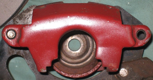

Here is an unmodified GM Metric caliper:
 Unsightly...
Here is a GM Metric caliper that I ground and sanded smooth:
 After I sandblast and recoat this shiny red, it's something that I could display behind an open-spoke wheel.
For smoothing castings, I use a combination of: Angle grinder / thin cutoff disc (for cutting off huge chunks) Lathe/milling for more "controlled" material removal Angle grinder / flap wheel Angle grinder / grinding disc Files Sandpaper Wirewheel

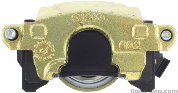

You know, at least for the Camaro version of the Metric caliper, PowerStop will sell you reman ones that are already powder coated red. RockAuto carries them.
