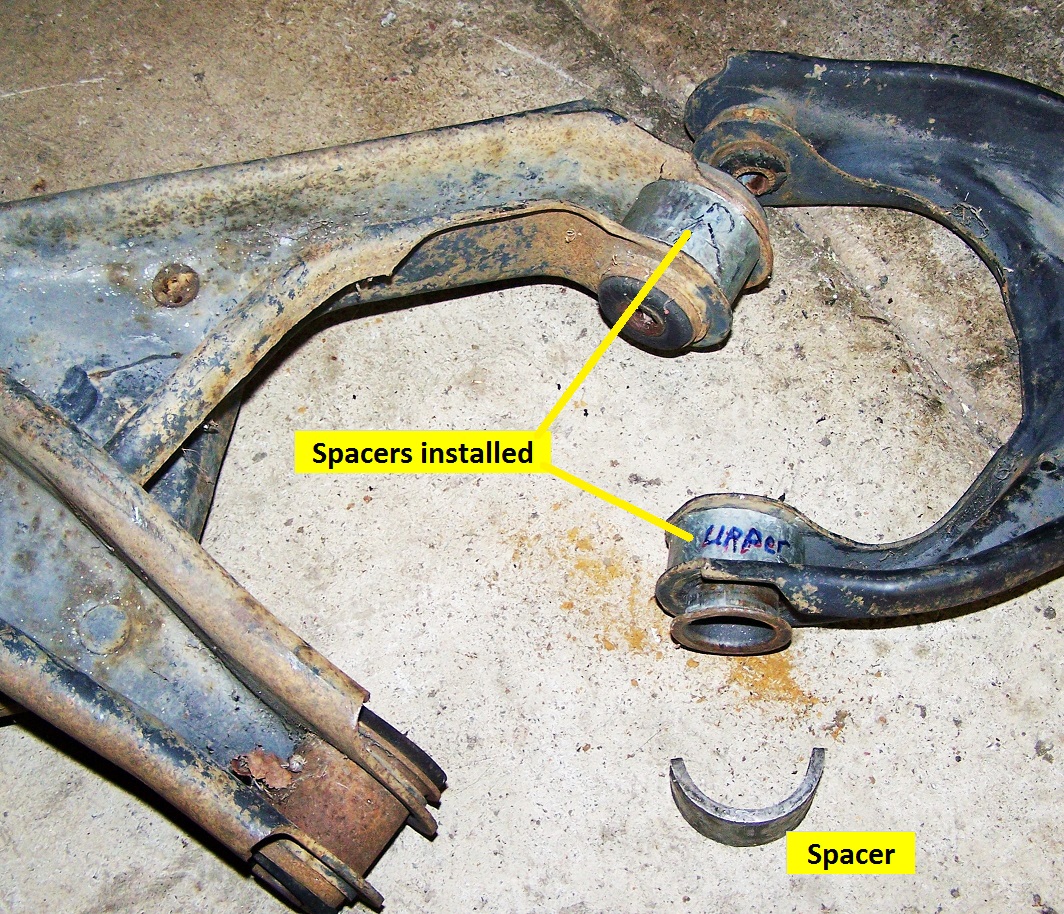

You can get a bushing removal tool set from O'Reilly auto parts- they charge you for it but when you bring it back they give you back the deposit...
I also bought some metal tubing and made half-round spacers so the A-arms wouldn't crush while pressing out and in the bushings

I se that you are working on the rear 88 suspension so you don't need my spacers...But if you ever do your front A-arms here is what the spacers look like;

quote | Originally posted by cvxjet:
Is this to prevent crushing while removing?

cvxjet
JAN 04, 11:25 PM
quote | Originally posted by ragoldsmith:
Is this to prevent crushing while removing? |
Bing!....(Now where did the other part)...Go!
