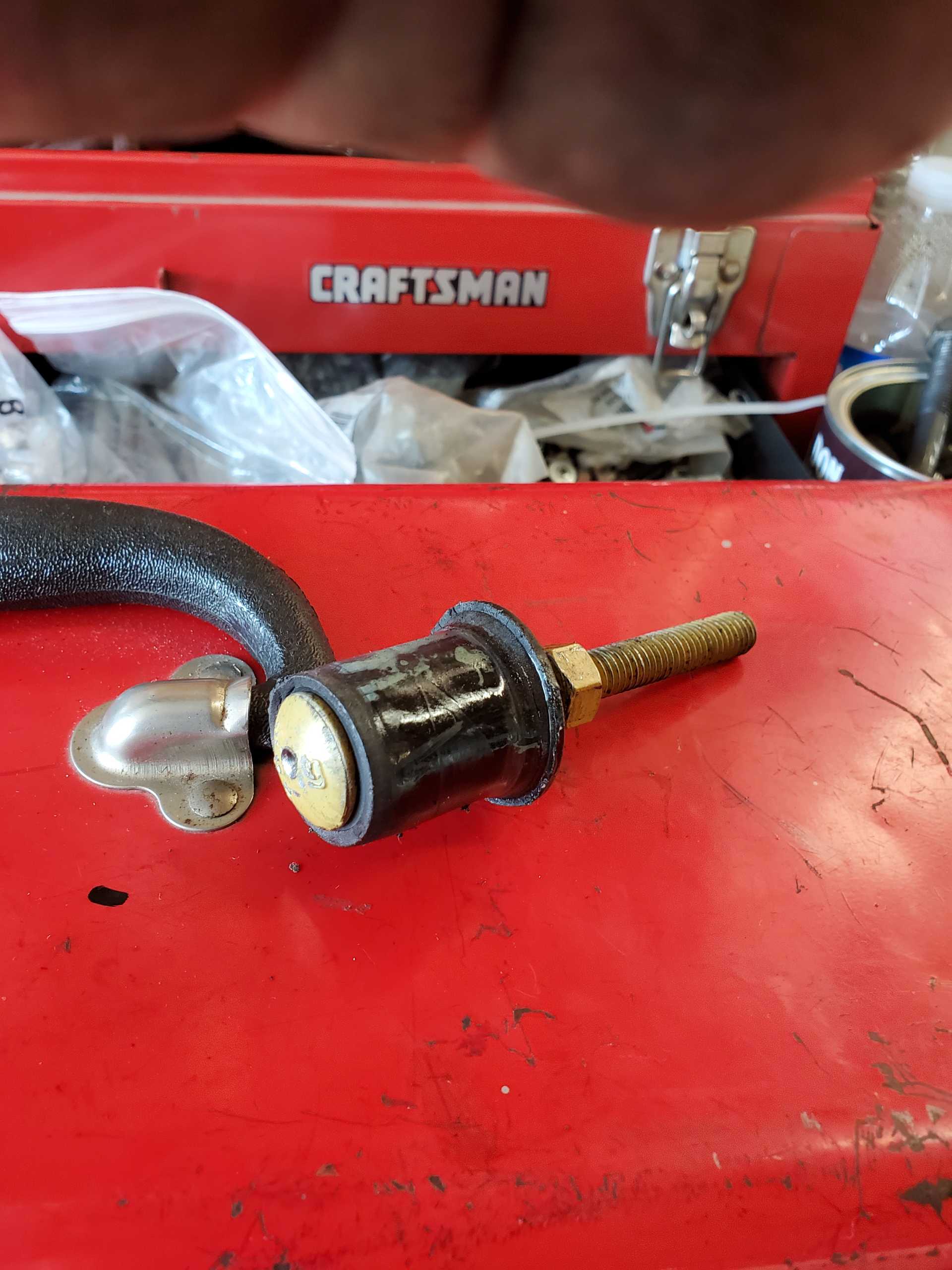

JAN 06, 10:10 AM
I should have included this pix to show what the nut was for. This is a shot of the carriage bolt with the inner sleeve of the bushing which was pushed out, still intact. Unthread the nut, and either keep the metal sleeve to be used elsewhere (I never throw away any free hardware), put the nut back on the bolt so you don't lose it and you're done.

I suppose it could. I just used the vice itself to push the new bushings in place. Just grease them up and push them in. Put grease on the inner sleeve, too. One thing you need to do, and I have seen this on a post in here, is to cut a piece of pipe to put in-between the lips of the control arm so when you press the new bushing in place, you don't crush the opening where the bushing fits[This message has been edited by eti engineer (edited 01-07-2021).]
