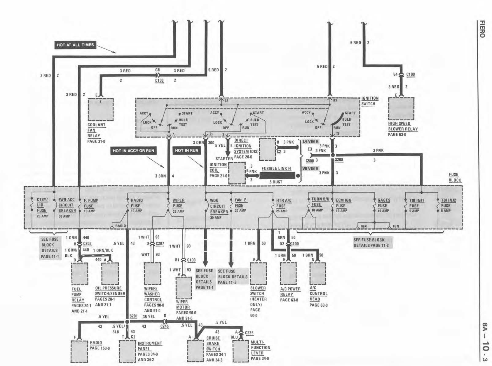

Overall, you really need a copy of the GM manual. Get one on Ebay or the like. You didn't say what year yours is, but assuming it's NOT an '84 and is otherwise like my '87, here's a copy of the relevant page that's easier to read than the above. (I'm old and really like easy to read )
See "Hot in accy or run" on the left; says "3 BRN" and goes to pin A on the ignition switch. Check voltage both ends of that wire, and then start considering the switch.
