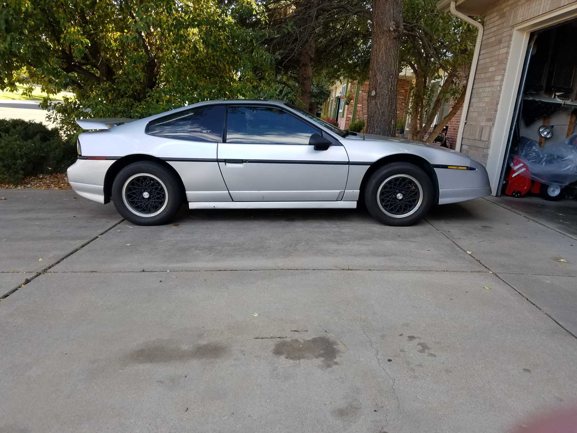

I did not see mention of the year of your Fiero. But if it is an '88, the redesigned suspension tends to sit that way a bit. That's why I installed a pair of Rodney Dickman's 1" drop lower ball joints on my '88 GT. Leveled the stance right out. Pictures below illustrate this.
With stock lower ball joints:
With Rodney Dickman 1" drop lower ball joints:
