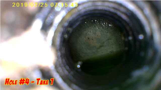

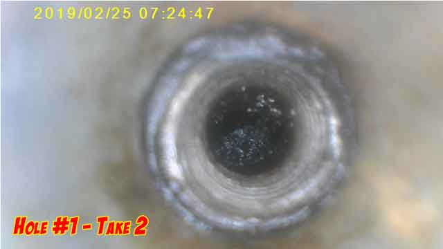

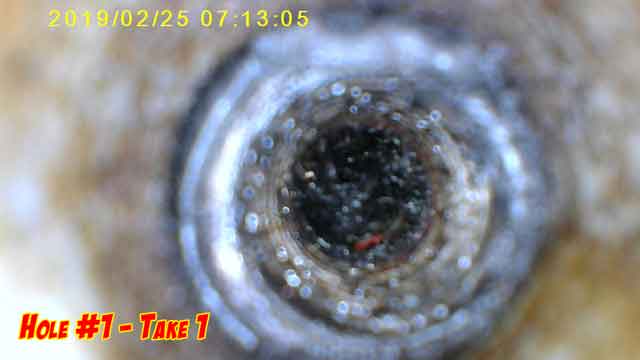

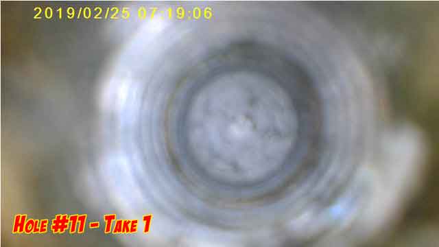

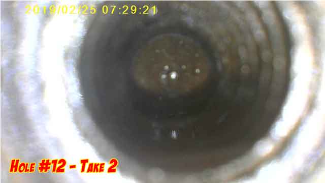

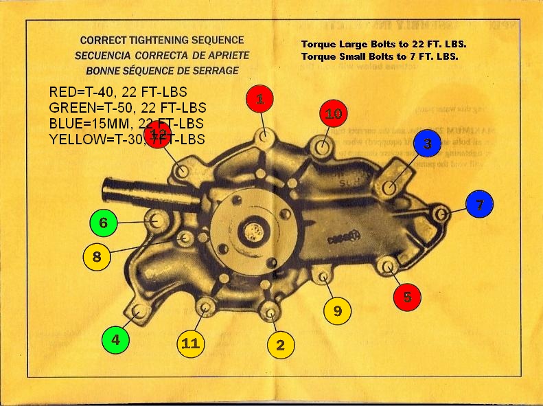

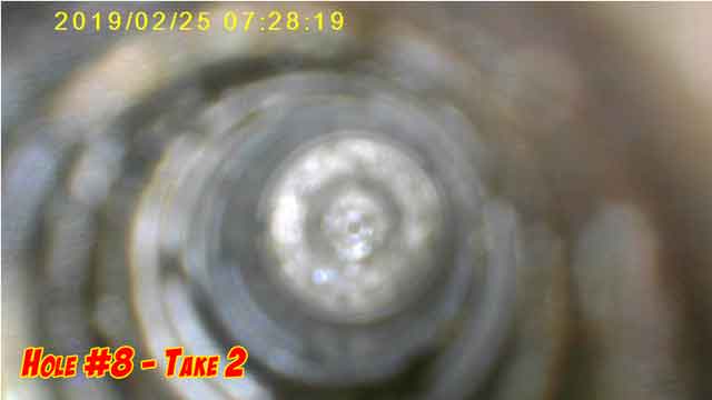

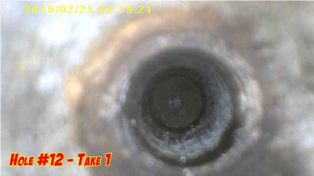

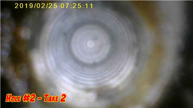

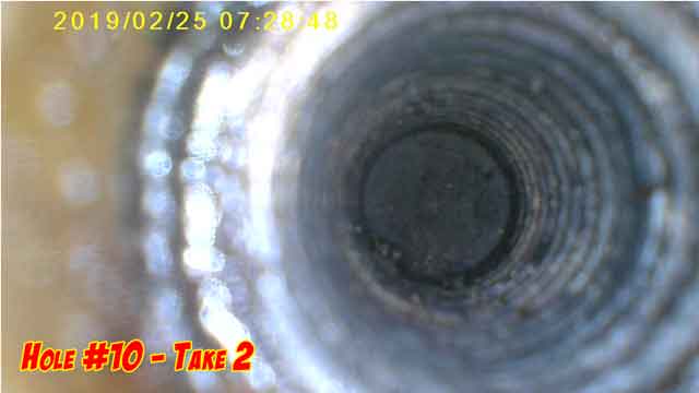

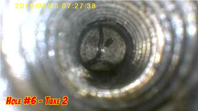

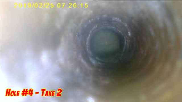

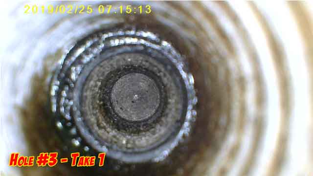

That's a very nice study with the boroscope! On my 88 2.8L I just sealed hole #4, no leaks.
Will
JAN 15, 02:23 PM
Diligent work. Thanks for sharing!
