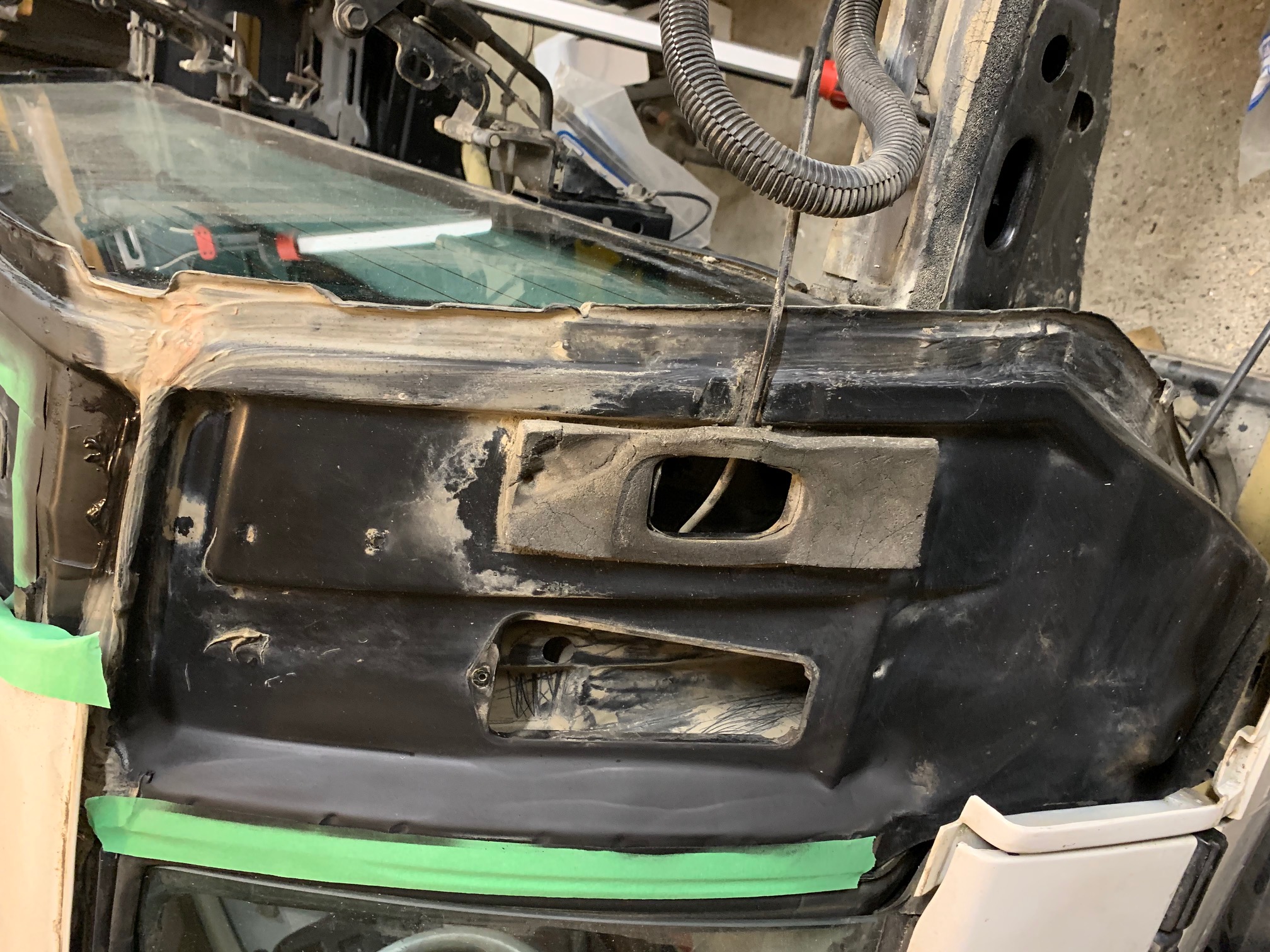

Hello all,
Does any one know of where to source, or how to make, replacement foam pads that sit under the sail panels? This is an 84 car if that helps. My foam is now crunchy and does not provide any cushioning to the sail panels.
Right in the middle of the picture.
Thanks
Spadesluck
JAN 25, 01:12 AM
You can cut to fit any type of sticky foam. Not sure anyone makes a specific just for that spot.
fierofool
JAN 25, 09:00 AM
It would probably be best to use a closed cell foam for that area to prevent water absorption and retention. Closed cell would also retain the adhesive surface for a better and longer bond.

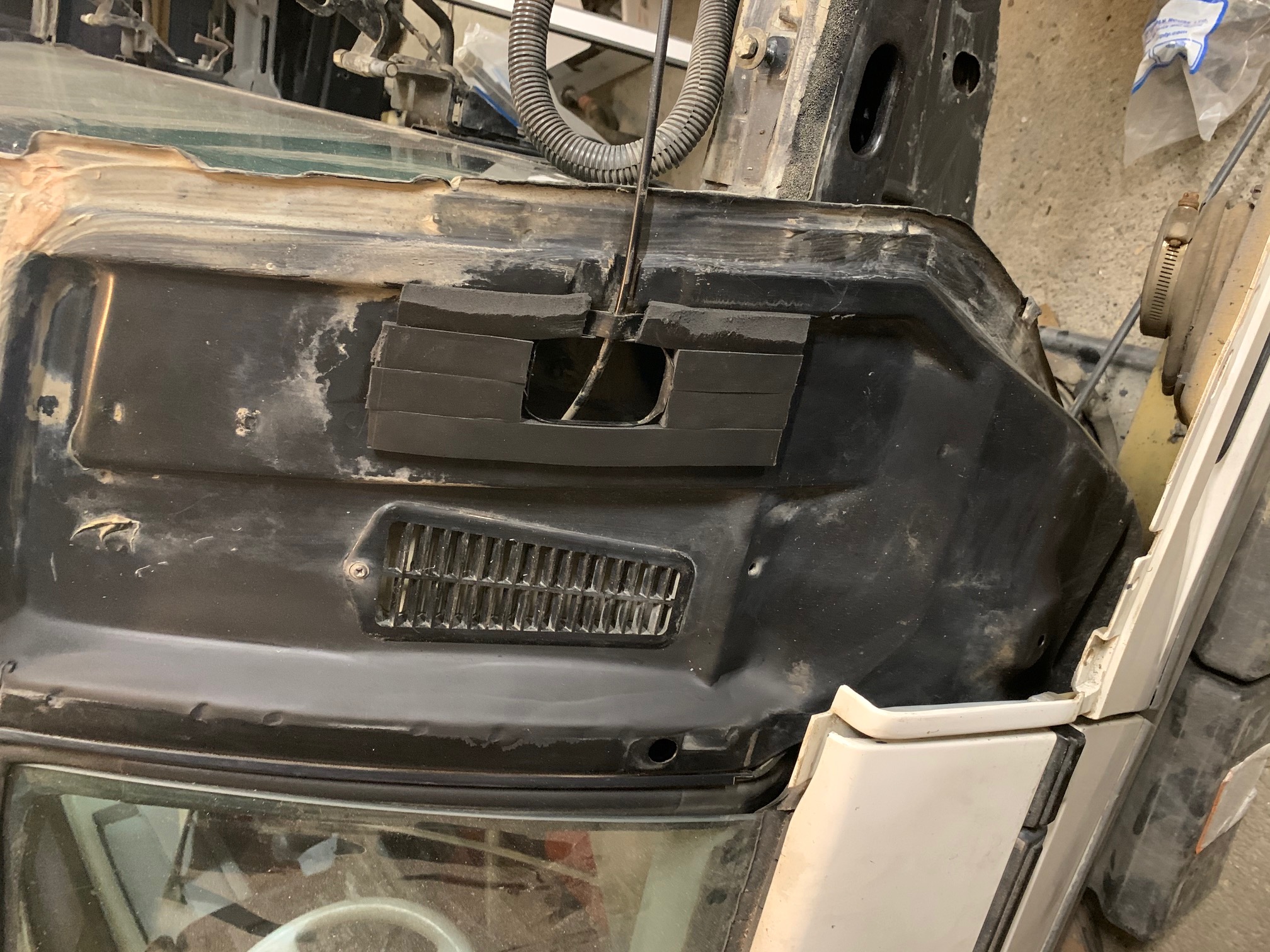

I figured it was worth a follow up post.
Ended up using window sealer foam from home depot.
Carefully tore off the old pieces, cleaned everything up with rubbing alcohol, and then marked the area that needed to be covered.
Finished product. Will it last long term? No idea. The old stuff lasted 37 years, so it should be ok.
