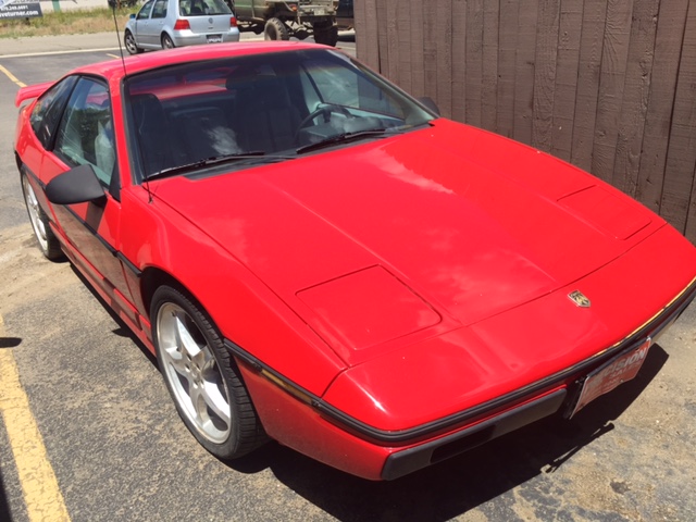

This is a very old swap that merged a 89 Grand Am ECU complete with the merging of the wiring harness to the 84 wiring. The original ECU did not output to the speedo, the signal came directly from the VSS to the speedo. The Grand Am VSS goes directly to the ECU and then to the speedo. There was a guy in Durango CO that specialized in Turbo Quad 4 swaps (20 year ago!) and as I remember it required adding a resistor to the stock fiero speedo. I know this is a long shot but anyone that has used that ECU probably knows how to wire it. Any help would be much appreciated. Steve
