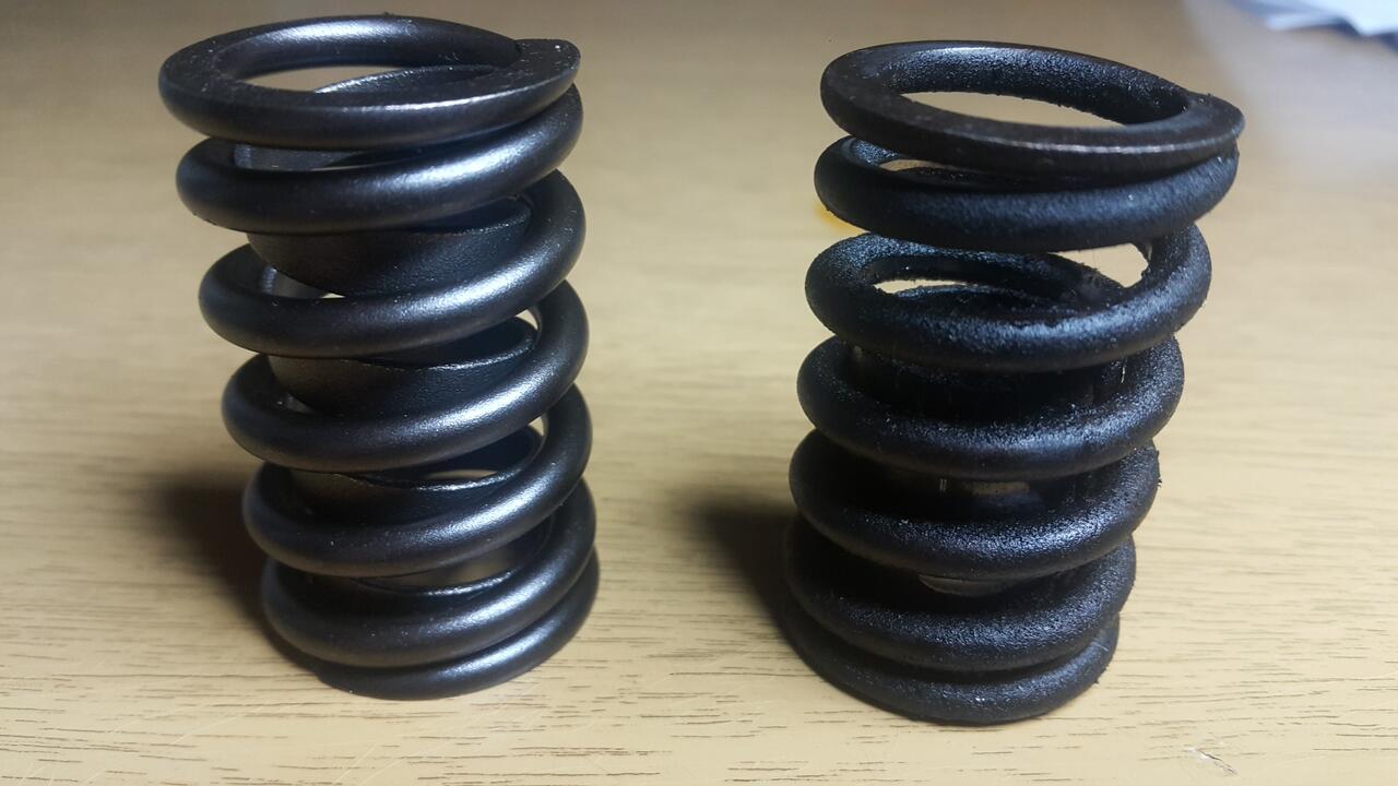

The shields probably won't fit inside the new springs, anyway. But it's not a big deal. You can leave them out.

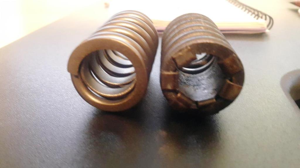

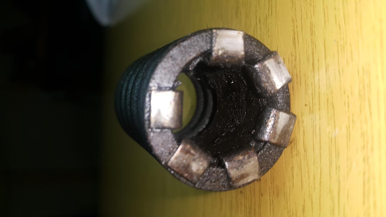

Knowing that GM would not put in a part that it could leave off and save 2 cents/car, what are the shields supposed to do? There's filtered air flowing through the valve covers, oil vapor, exhaust gas ... presumably these protect the valve stem seals??
pmbrunelle
FEB 05, 08:01 PM
Those are dampers.
They expand outwards and create friction with the spring's coils as they rub up and down.
The idea is to damp unwanted oscillations/movements of the middle coils.
Here we can see the middle coils of a valve spring moving around:
The damper and spring are made to work with each other, so I would use the GM damper with the GM spring, and your aftermarket damper with your aftermarket spring.
