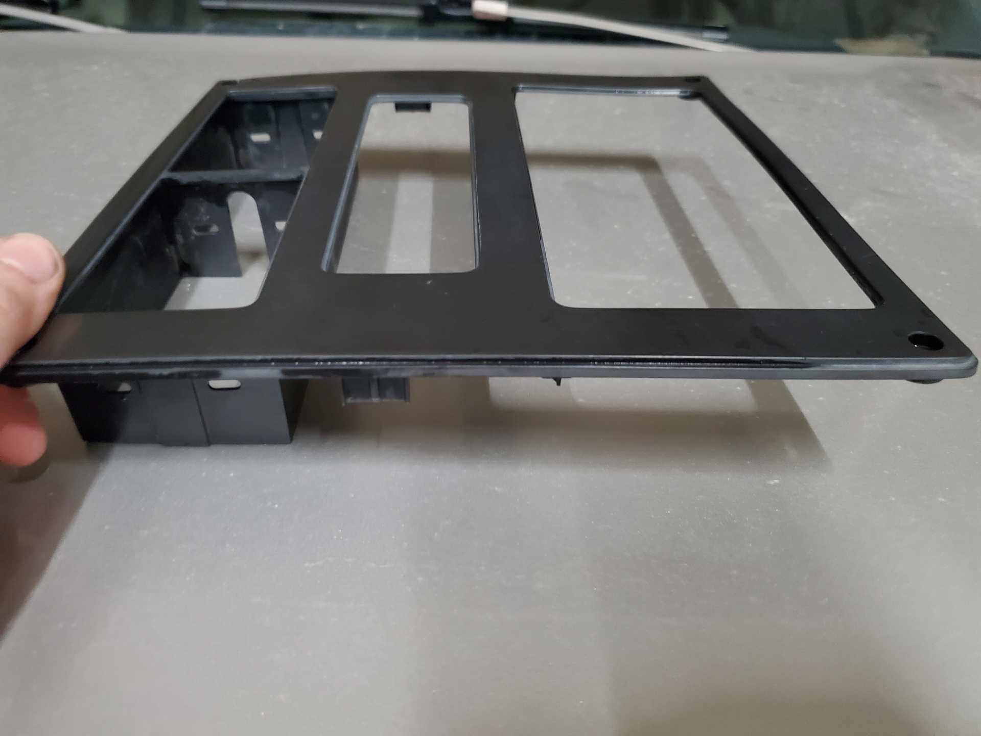

The radio bezel is pushing out quite a bit in the center, and it doesn't look very nice. I noticed it when I installed a new stereo system, and it look like it's just getting worse each time I take it off. I've looked around for a replacement, and I can't find a reasonably priced one. I'm working on designing one to 3D print, but I would prefer to repair the one I already have. Does anyone have any good ideas to fix this?

The fix I have used with success was to remove the vent pieces from the section and place it in a container where it fully fits laying flat face down, or as flat as the warped piece can. then I would boil a large pot of water and once the water reaches a boil add the water to the container with center section and wait a few minutes and then add whatever I could that had weight to it that would not crush the part and let it sit until the water had cooled off to where it was no longer warm. The hot water will soften the plastic and weight will help flatten the part out and once the water cools it will now retain the flatten shape. Best to have a plan on what you will be using for weight and how you will place the weight on the center section so you are not trying to figure things out as you add them as it will speed the process up. also once the weight is added it will absorb the heat from the water since it will be room temp so hold back a bit of water to keep the temp where it needs to be to make this work.

I second the hot water method. Slow even heat. ------------------ Stanton '88 Formula, red on gray

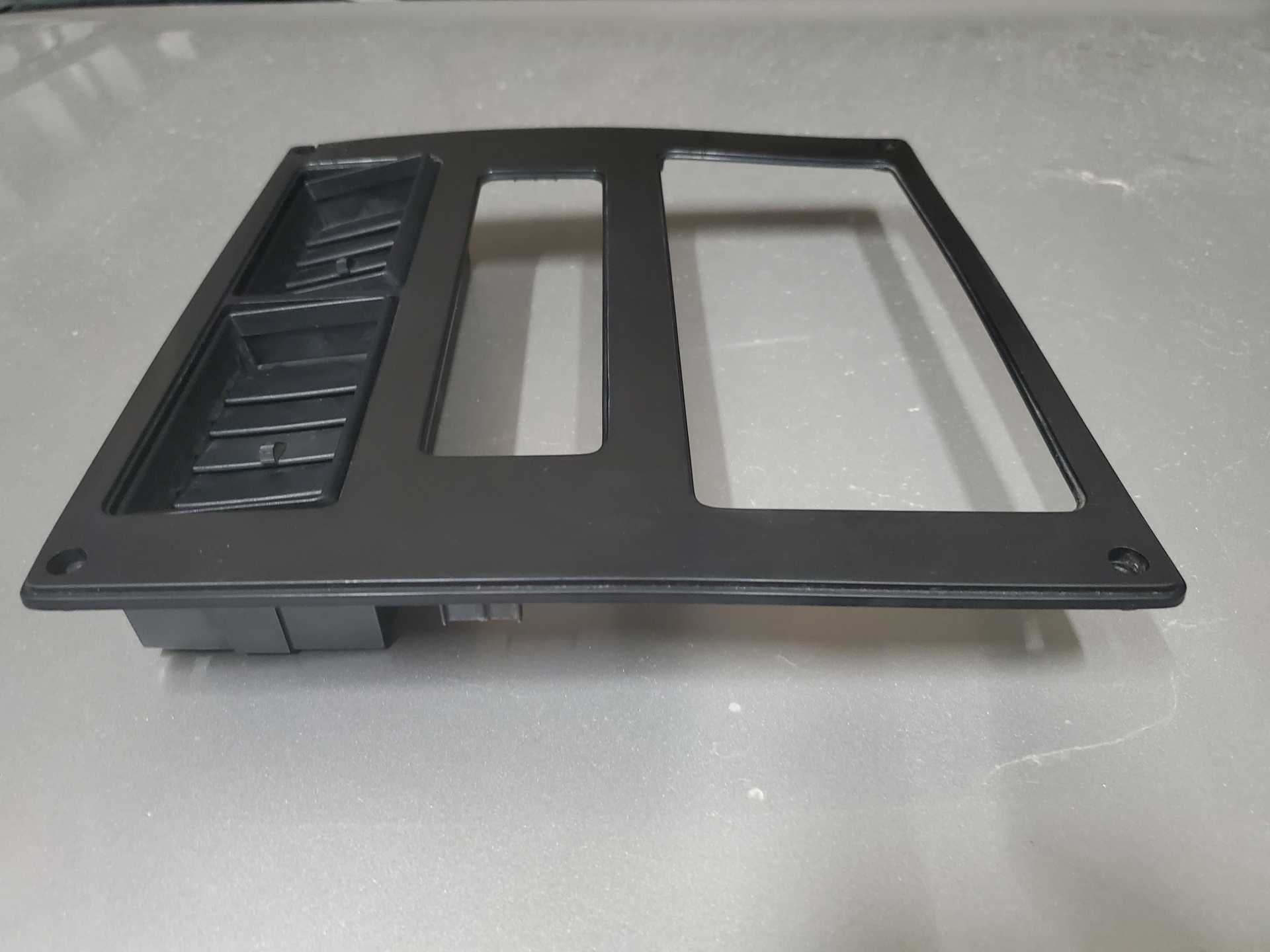

I tried this out, and it worked great. I put it in a pan, and used some mugs full of water the weigh it down. I also put some spoons under the center to help push it out. I poured some boiling water in, and repeated the process four times. Thanks for the help, it's not perfect, but i'm very happy with the results.
