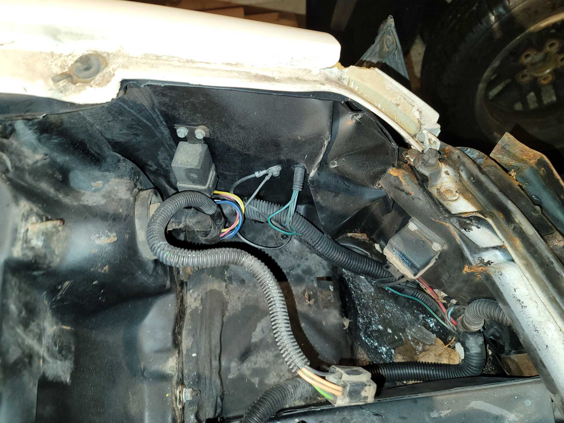

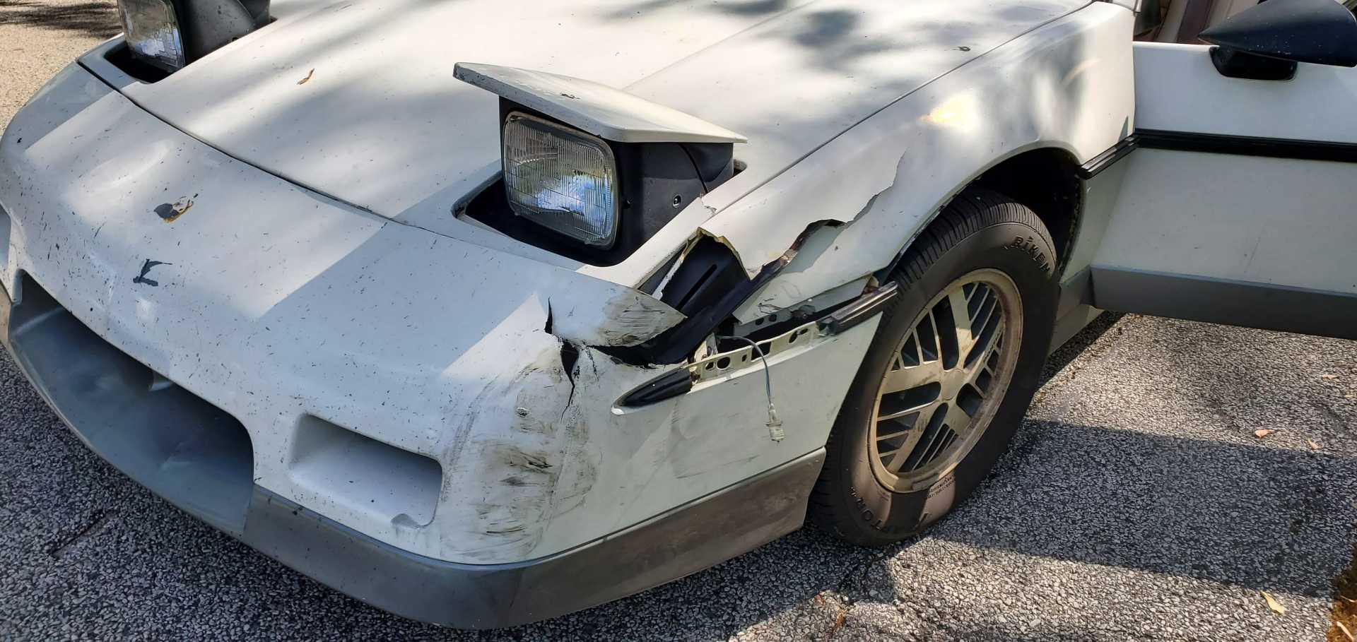

Hey everyone! I was in an unfortunate bump a few weeks ago, and finally had the chance to start working on repairs. Intersection confusion led to my 85gt's front driver quarter in the rear quarter of a ford fusion.
The body damage isnt horrific, and she tracks straight and runs fine other than a new periodic coolant leak from the rad area, but the steel that surrounds the headlight 'bucket' / area it retracts into is mangled as heck.
Frame measures as straight still, so I think the majority of the damage is on the facia mounting bars and the steel of the headlight bucket. Pics are attached. My question is: how do I go about starting to fix this? Since it's folded in and pushed back, it's not something I feel like I can 'pull' out. Would cutting the bucket out and rewelding replacement material be my best bet?
Any advice, as always, is greatly appreciated!

Take it to a good, reputable body shop and have them remove the bumper fascia and the fender. Then have them pull the damaged area on a frame straightening machine. They should be able to pull most of it out or at least to a point that the headlight bucket can be installed. It probably won't inexpensive but it can be repaired. [This message has been edited by Mike in Sydney (edited 02-07-2021).]
FEB 07, 08:46 AM
Depending on your skill, I would cut out the damaged area and find a donor chassis for the needed material.

Is there a name for that area other than 'headlight bucket's haha? Seems like overkill to buy a chassis for this, but want to be able to ask for the right thing at a junkyard or two around here.
I was thinking frame pulling machine, but the steel seems a bit thin to really yank on much, plus the folding (see pics above). I'm concerned that if that 'bucket' is just bolted on in a few places, Itll just end up getting ripped off the car. I haven't found a bodyshop in the cleveland area that will price work on fieros reasonably - I tend to get "it's old, it's expensive". Any advice on finding folks?

Too bad you are so far away. I have that section of car. My GT had similar damage i knocked most if that area back out with a 2x4 and 4x4 (depending on the area) and a hammer (3lb and up). Its really really thin sheet metal. You may have to evaluate if you need to add support as the stamping on the metal is what gave the thin metal its ridgidness.

I suspect one reason you are getting pushback from the body shops is that they are unfamiliar with the car and can't put a price on it. Most body shops do insurance work as their principal business. Getting the cars in and out again quickly is the way they make their money. Pull the fender, fascia and wiring out so the shop can get a good look at it. The more they can see the more likely they are to try it but it won't be cheap. I'm guessing they would charge 10-15 man-hours at whatever rate shop rate they charge and that's just to straighten the damaged area. It they take it on, they may add a little heat before pulling to make the metal more workable and since like Skywurz said, the stamping helps to give the sheet metal its strength, they may weld in some reinforcement. The metal is thin but I believe you can pull most of it out. I've seen it done on similar accidents.
Like Olejoedad said, depending on your skill, you could cut out the damaged area and find a donor chassis for the needed material and weld it in. It's not a job for the inexperienced. Lots of alignment and welding will be needed to get a good job. Again, a reputable body shop is the go, here. I think the time required is 8-10 man-hours plus whatever the salvaged clip costs.
I think the front fascia and the hood can be saved but it looks like you'll need a new fender but those are available from the wrecking yards. The side maker light and trim should be available from the wrecking yard, too, or you can get them from TFS.
BTW, how's the bulkhead where the headlight assembly attaches? Is that OK? If so, you may be able to use a small hydraulic jack yourself to push the damaged area back out to the area where it's supposed to be. Just make sure the jack is on a wide base so the load is spread over a large area.
The good news is the “soft” body panels on the Fiero can hide a lot of internal repairs so if the car isn’t going to be in the Concourse competition at Pebble Beach, you should be able to get an acceptable result so long as the attachments points on the frame are in reasonably close alignment.

Ogre - do you happen to have a reference for what's considered a 'rigid zone' for collision protection and what's more of a 'body/facia support' ? I checked the cave, may have missed it. The collision was at about 15mph, just at an inconvenient spot thanks to the location and other cars height. I spent today rechecking frame distances, everything's within tolerance of where it was when I bought the car last year - so I'm not too concerned. She sat for a decade or two in a dry barn, so frame and undercarriage is better than expected for a NE Ohio car.
Skywurz - I'd been considering the 4x4/wood+sledge approach. Any pics of your jig, and how you got stuff back up to shape for panel fitment? It really is so thin - I had been leaning towards just cutting out a new box and front fender curve from scratch since it feels a bit like trying to uncrush a soda can haha.
Mike, bulkheads are totally fine - I like the hydraulic idea, mostly for the finessed approach it would give me. I'm more confident in trying some 'pushing and oulling' knowing the metals thin, but not too thin to take a bit of manipulation. Hearing that you've seen similar accidents resolved with a puller makes me feel better.
Either way, totally agree re:body shops not wanting to take either the liability or the job thanks to age and limited experience. If I had an existing relationship, I'd be dropping it off - but especially in Cleveland, I trust my own hands more than anyone whose work I haven't seen up close.
Bit of background: I am experienced with manual and CNC machining as well as welding at just above the hobby level (help folks make or fix parts, etc at cost) and have access to sheet forming tools, cnc plasma table, and other gear. Sadly, since im further from the automotive "world" than I'd like, I don't know anyone with access to a frame rack, and shop rates are going to be well over the value of the car - so this is likely going to be a diy or di(many experienced friends) job, but outside of this forum I don't know too many fiero people - y'all are a treasure trove of support and knowledge.
I'll take pics and let y'all know what route I end up leaning towards. Luckily, no massive rush so while she's apart and on stands I'm taking the chance to bring some other seasonal maintenance and deferred care items/upgrades. Might as well![This message has been edited by cle_fiero (edited 02-07-2021).]
