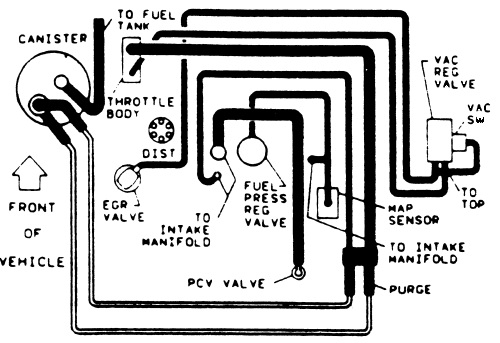

This sounds to me like something that must have happened when you were changing the injectors- Go over everything you did and look at which hoses/pipes go where......

I dont remember exactly but i swear i read something about if the PVC system gets clogged it can force oil into the intake. or something to the gist of that.
