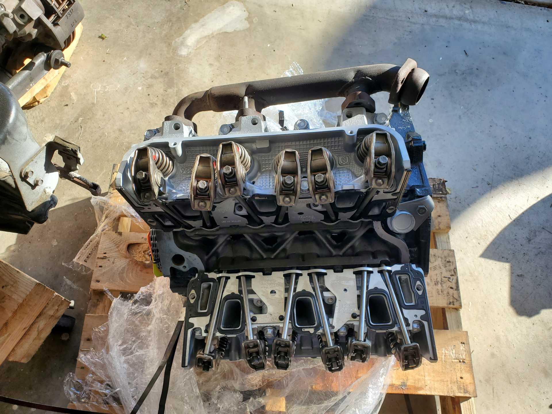

I'm definitely not an expert but from what I've seen the L32, 3.4L 6-cylinders from the 1993-1995 Firebirds or Camaros are the "drop-in" replacements for the L67, 2.8L 6-cylinders in the Fiero. You do have to swap sides for the starter and probably uprate your injectors but that seems to be the easiest and least expensive because most of the things you take off the 2.8 bolt on to the 3.4.
My guess is if you're going to stick with the LA1, you'll need the intake off of an LA1 so everything in top end aligns. Maybe some of the other Forum members can give you a work-around so you can use the intake from the2.8.
Good luck.
fierofool
FEB 27, 09:03 PM

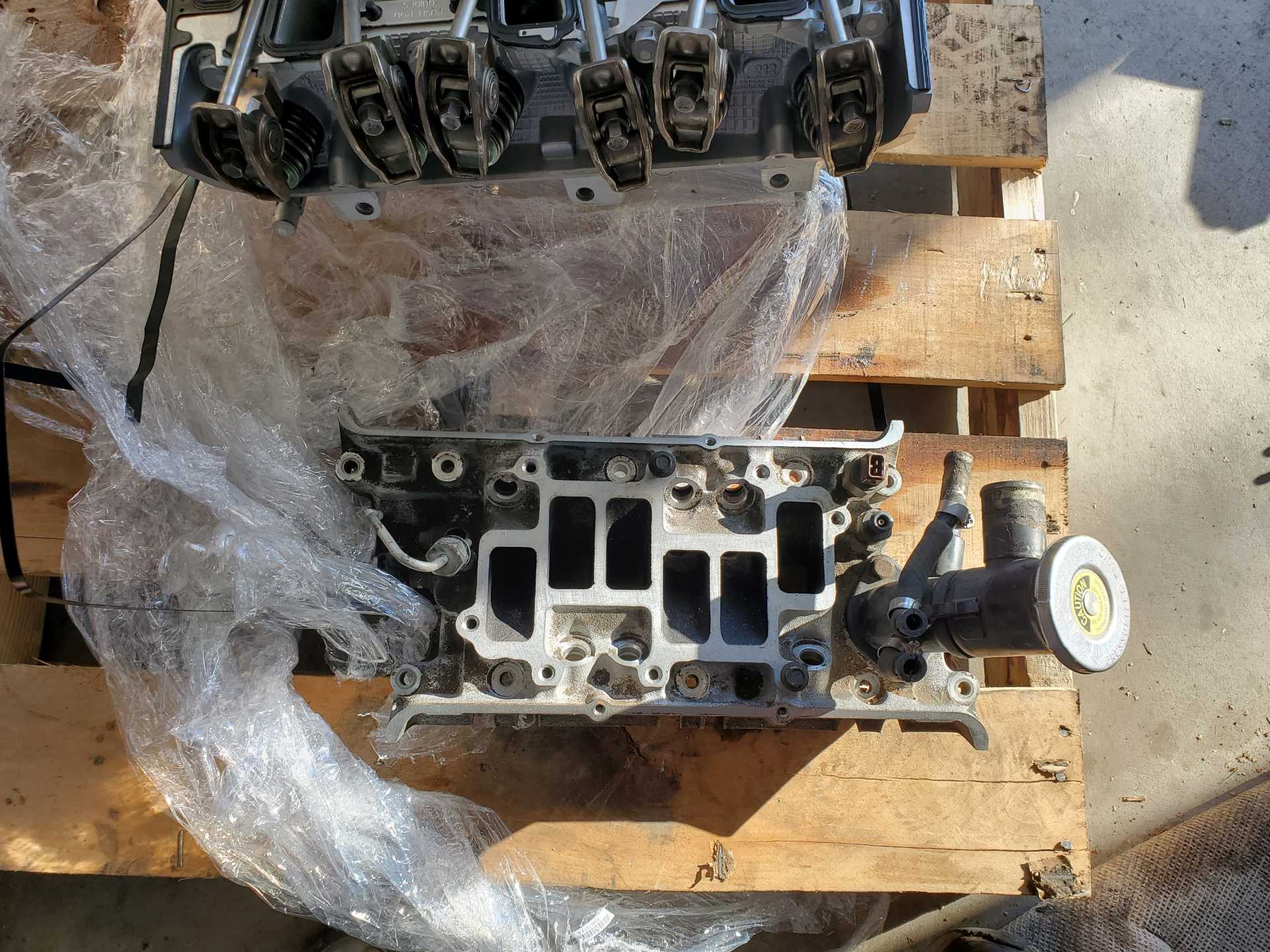

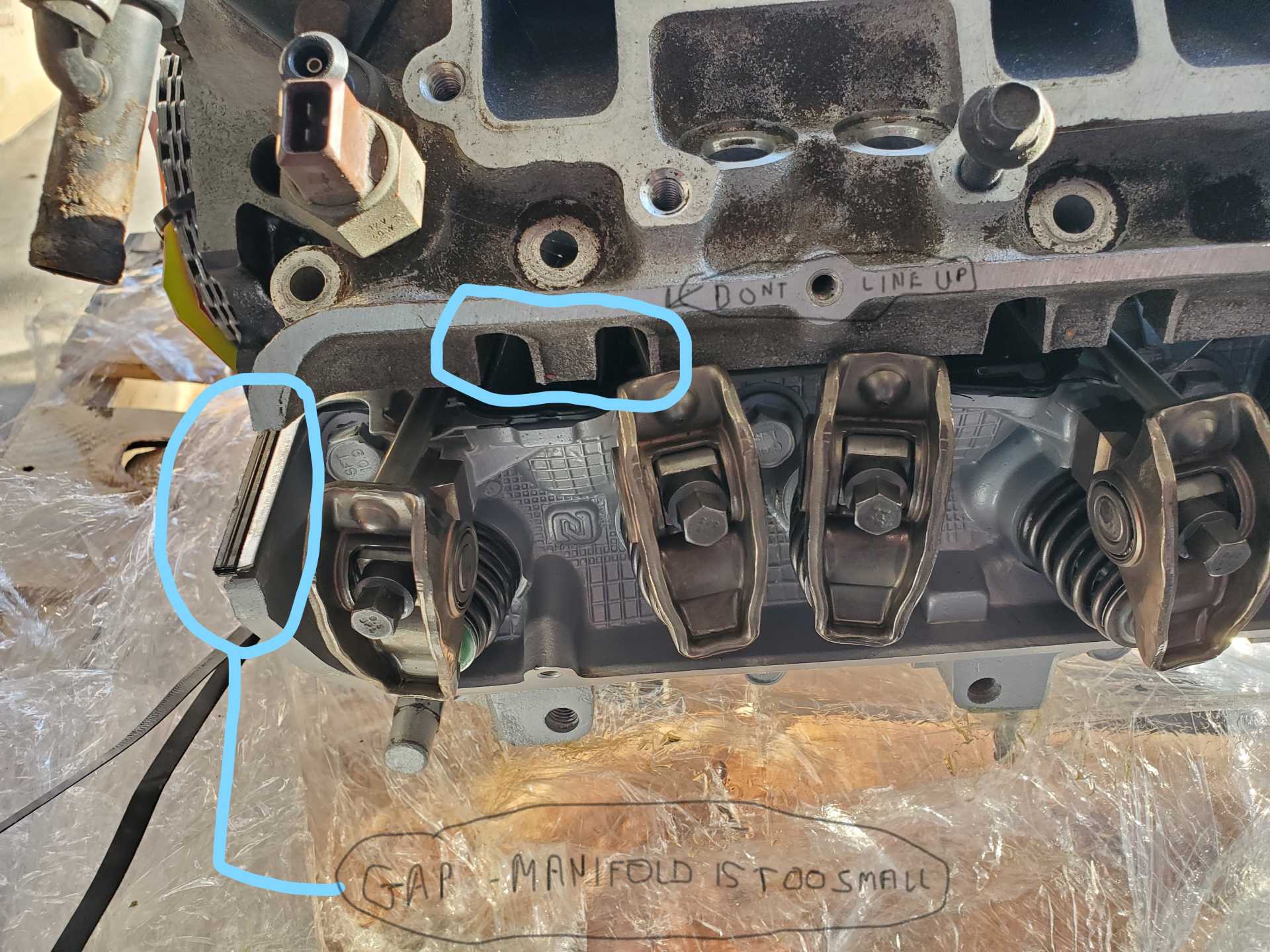

Your replacement engine has aluminum heads. The Fiero intake system won't bolt up to aluminum heads. Like Mike In Sydney, I know little about your replacement engine, but from what I read, most aluminum head engines require different pistons at a minimum, when iron heads are installed.
FEB 27, 09:29 PM
The Fiero intake will only bolt to iron heads. Period. The only 3.4 that comes with those heads is the L32. That engine came only in the 93-95 Camaro or Firebird.
pmbrunelle
FEB 27, 10:40 PM
You have three options:
1. Complete the "3400" Gen 3 swap using parts from a donor car. Then, get it past California smog.
2. Remove the aluminium heads, and install Fiero iron heads + intake onto the LA1 shortblock. Yes, this will result in a low compression ratio (slightly reduced torque and fuel efficiency), but it works. I have "3100" pistons and iron heads on my Fiero.
3. As per option two, but replace the LA1 pistons with the L32 Camarobird pistons to restore the compression ratio to a more stock level.

All of those are viable. But there is an "Option 4".
Send it back (assuming you still can) and specify a 93-95 Camarobird 3.4. L32. VIN "S".
Drill holes in the left "wing" of the block to move the starter to the other side. Rodney Dickman sells a tool for this exact job. Bolt on your Fiero intake and accessories, and a small brass oil sender fitting (nitpicking, here) and call it a day.
This is the simplest way to accomplish what you want to do, and still look like a stock engine to the CA Smog Jockeys.

I'm pretty sure this was already covered, in previous thread. Anyway, yes that looks like an LA1 (aka 3400 SFI). It has aluminum heads. Your Fiero engine parts will only fit a 3.4 with iron heads. And the only 3.4 that came with iron heads was the '93-95 Camaro / Firebird.
GM made several versions of the 3.4 V6 engine, and they're all different. So when you purchase a 3.4 V6 from an engine supplier, you need to be specific, or you'll get the wrong one. In your case, you want the 3.4 V6 with iron heads. Once again, that engine only came in the '93-95 Camaro and Firebird. The engine code is L32 (not LA1).
You could modify that 3400 to make it work. But to do it right, you'll need to throw away half the engine and replace it with the correct parts.
