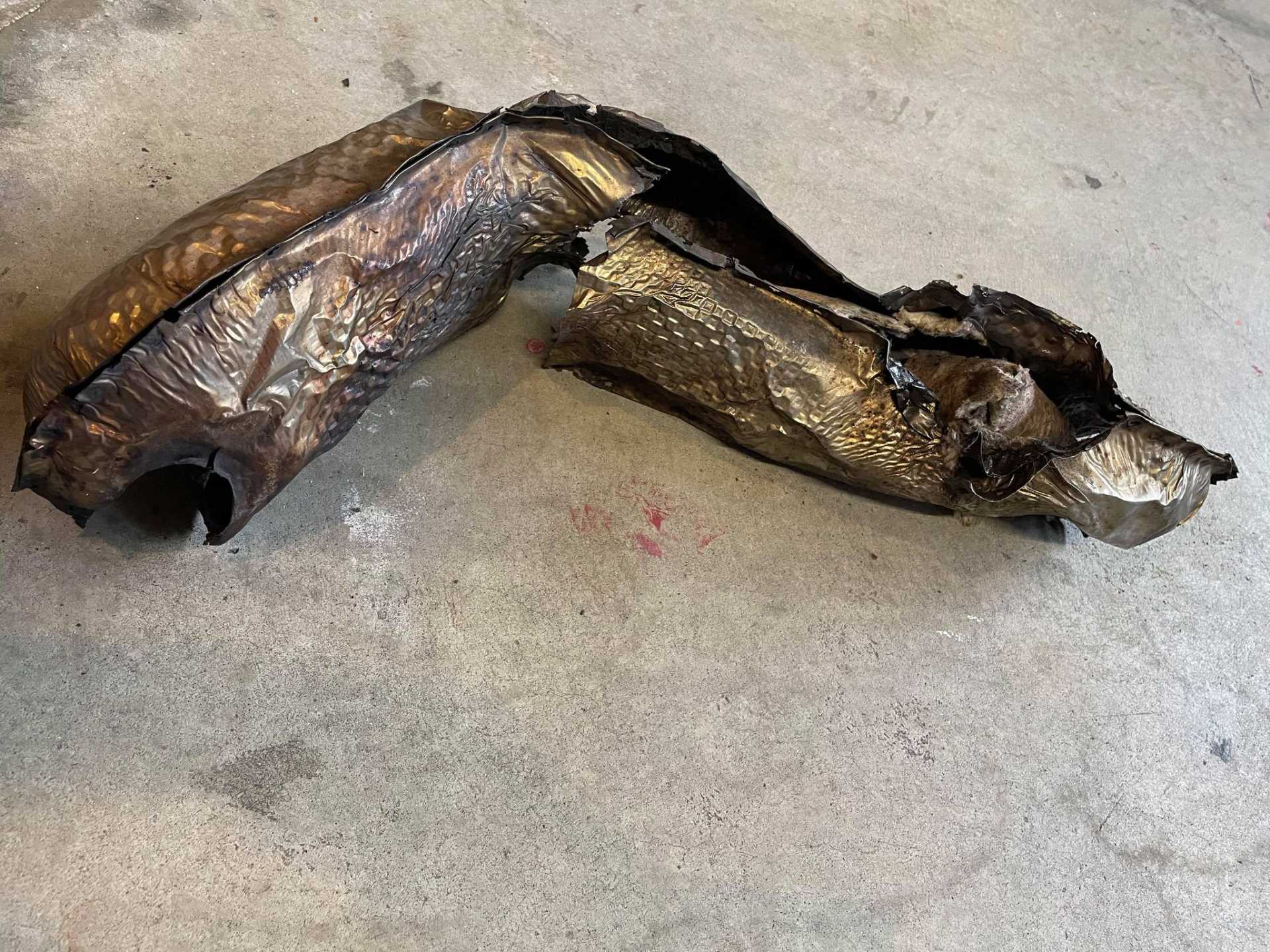

Hey all - replacing my y-pipe and the heat shield material is really sketchy. Anyone have any good tips on materials to use? This is the 88 version, so its the foil type. What is the material under the metal - fiberglass? Are there any patterns out there?

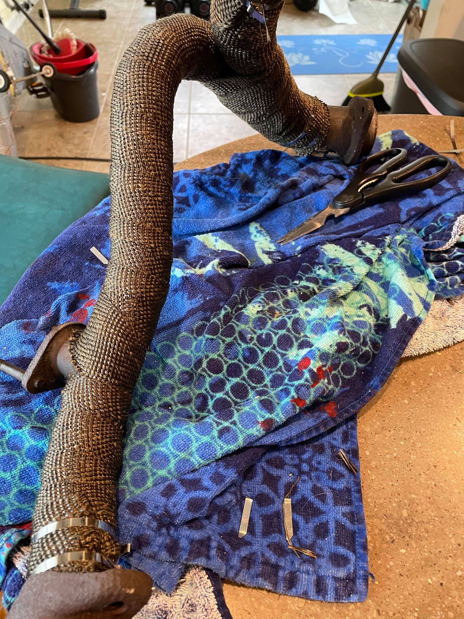

tnkgnr
MAR 16, 11:49 AM
Screw it - went with the heat wrap. I keep it garaged and once it dries, I'll hit it with the high-temp silicone spray.
MAR 16, 03:12 PM
The silicon spray works wonders.
