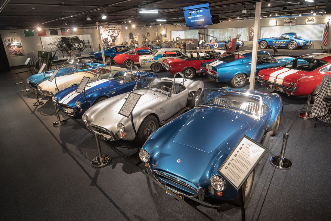

By the way, although the Muir house was interesting, the really big thing (That I originally thought was not going to amount to much) was the 2nd stop at the "Cobra Experience"....Holy crap! A bunch of Cobras, and other assorted cars, including an original (Still muddy from being found in a field) AC Ace (The car the Cobra is based on)...And a Daytona Coupe plus a real GT-40 with bundle of snakes exhaust headers- Which they started up!!!!!!!
After that I needed a PACK of cigarettes (And I don't smoke!)
Note; I grew up a "Ford" enthusiast- Pantera, GT-40, Shelby Mustangs, Cobras and Daytona coupes...I have a friend who BUILDS Cobra and Daytona kit cars- Real ones made from the original plans (The kits are made in either Poland or S. Africa)
