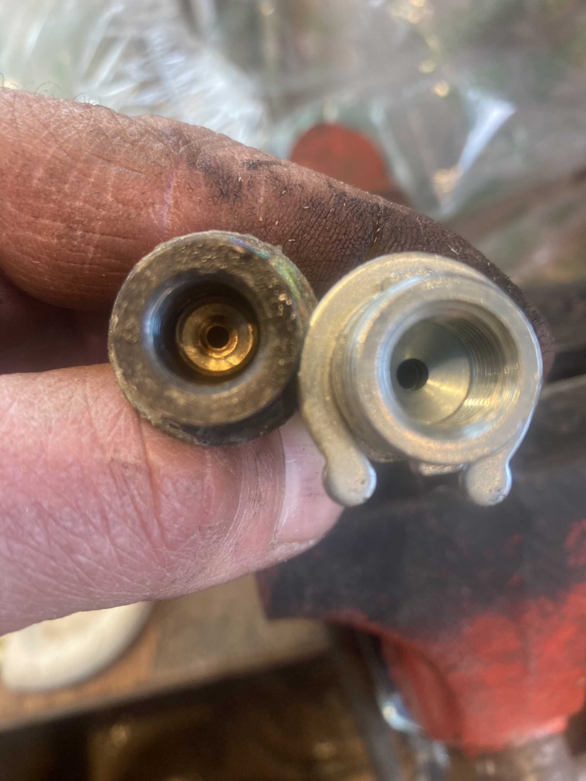

Hi guys, replacing brake hoses, the new ones I got are different, the fitting is like a funnel, the old hose has a flat fitting.
So do i have the wrong hose or was there a design change? Will they work on the stock metal brake lines?
First time I’m doing this so I’m not sure what’s going on. Help...

There ac delco from Rock, PN 18J417

Ok, learning more, I now Believe I have ISO bubble male ends,
Edit, looked in the service manual and it says double flair, I’m confused, its hard to tell what they look like , anyone know what the 86 has?[This message has been edited by hunter29 (edited 04-05-2021).]

I have a few sets of replacements from Centric.
They all look like this
I have pulled probably 4 sets of brake lines in the last 6 months and can't say I've actually looked in the holes on the old ones.[This message has been edited by skywurz (edited 04-05-2021).]

I think I have the right part, it looks just like that, I just want to be sure, thanks so much for the reply..

Just want to add, the old part is not as flat as I first thought, I think I have been fooled by an optical illusion..
