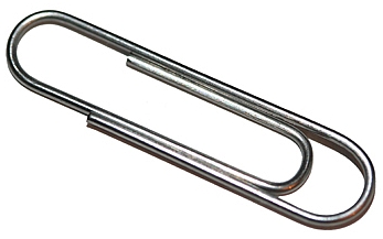

This is the high-priced piece of hardware (with minor modification) that I use to read codes.
fierofool
APR 23, 08:19 PM
I had to skip 2 days meals and got one for each of my 2 cars. I love them because they are so compact that I can keep them in the door pocket or the dash pocket. The batteries seem to last forever, too.
