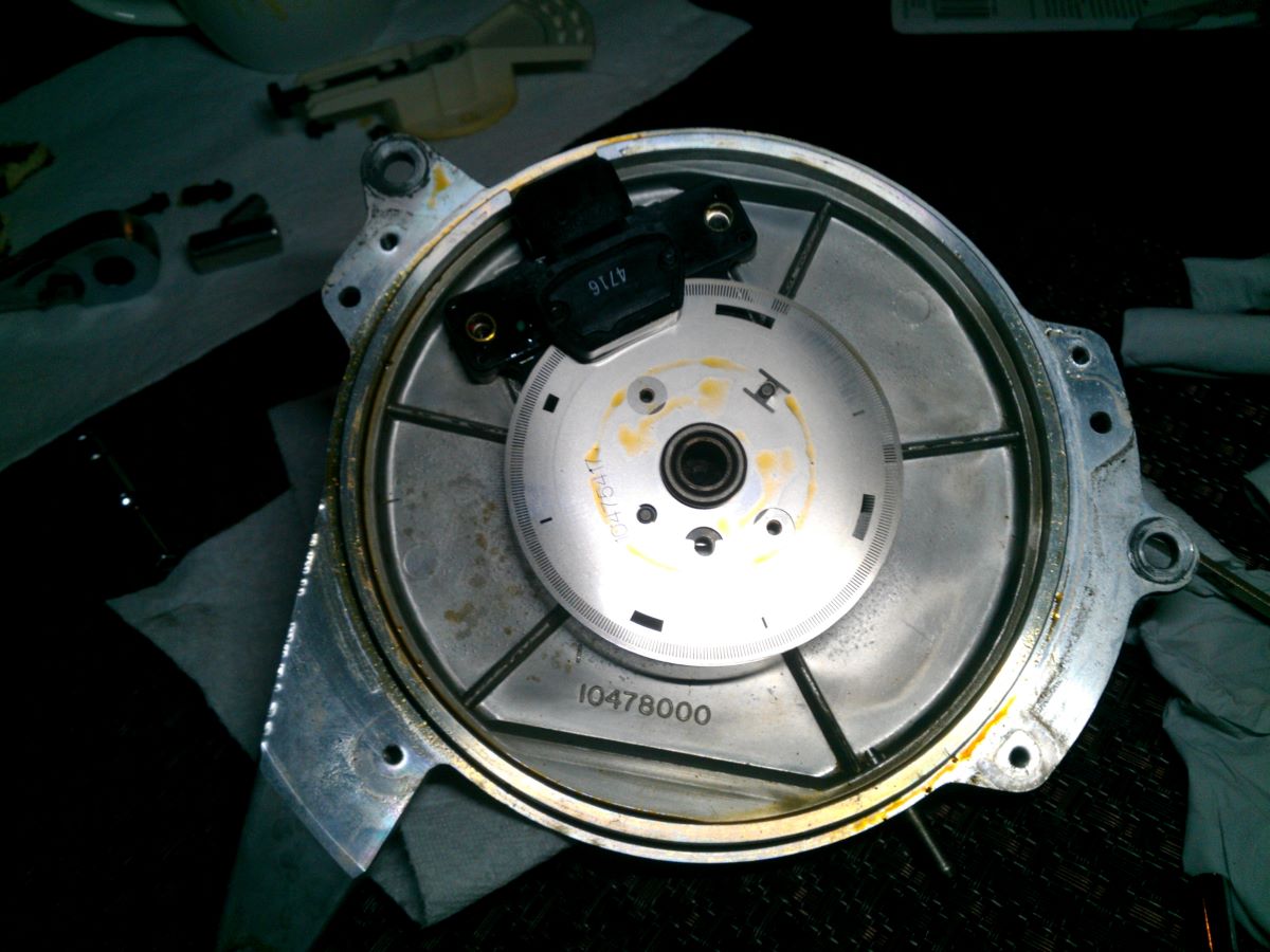

Optispark distributer is the usual culprit. MY optispart had oil in it and I had to take it apart and clean it to clear misfires.

I had the exact same issue as this, the crank hub seal was leaking, water pump drive seal and the Optispark seal was crumbling. Cleaned the Optispark carefully, replaced those three seals.. got less then 1200 miles and the Optispark failed.

| quote | Originally posted by str8maxn: CYRUS88 >>> The LT1 is out of a 93 Vette. How hard it to replace the optispark. . .
It's fairly simple, just tedious. I can't put it on a scale because I don't know your skill/knowledge level. For me it was about a 1.
If you have an LT-1 water pump, then it's more involved because you have to drain coolant, remove and reinstall pump, etc. I have a remote electric water pump, so I didn't have to touch the cooling system. I did have to tilt the rear of the cradle down to get the balancer and optispark out, though.
Be careful about the MSD opti, the rotor can fall apart inside (do a google search).
