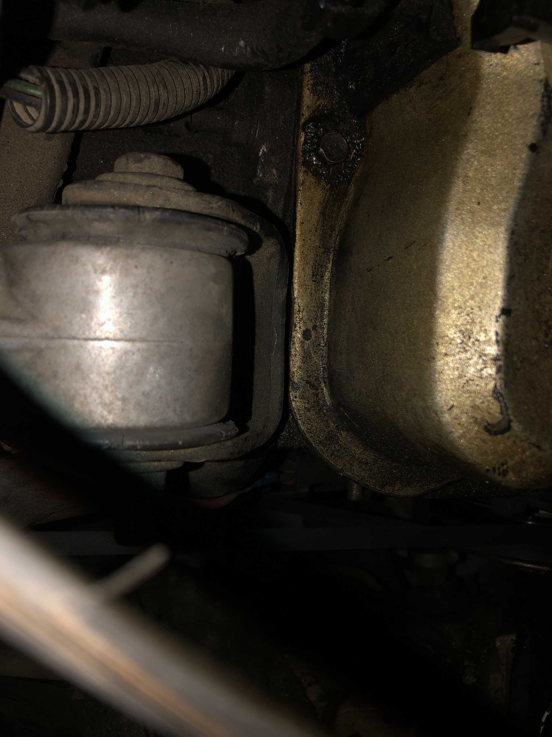

Anyone know the size of the bolt that holds the dog bone assembly to the engine? For a 4 cylinder here is a pic where the bolt goes------------------

I believe it's a 10mm but I don't know the length.

M10x1 5x85 10 9 POR PN 11504598
MAY 13, 10:44 AM
quote | Originally posted by Mark_j: M10x1 5x85 10 9 POR PN 11504598 |
The 10 9 part of that is Metric Class 10.9, equiv to SAE Grade 8, and Nut should be and maybe washers the same hardness.
"Standard" soft bolts can/will fail and get loose at minimum causing major problems like breaking the exhaust and intake parts because allow too much engine movement.------------------ Dr. Ian Malcolm: Yeah, but your scientists were so preoccupied with whether or not they could, they didn't stop to think if they should. (Jurassic Park)
