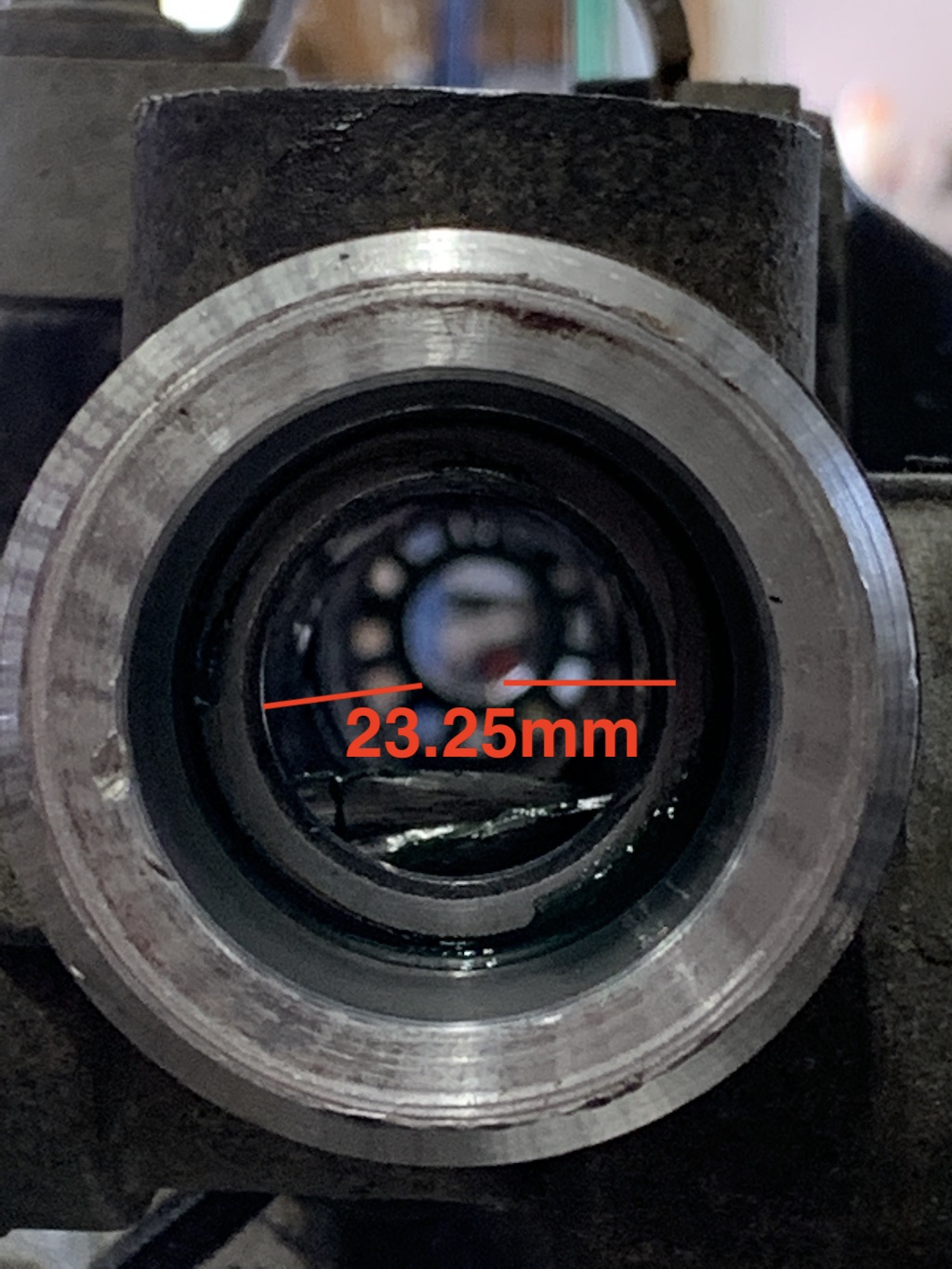

  But!   The rack itself is 21.96mm diameter (very consistent end to end, and again in 2 axis). The collar/bushing (on the left, not the plastic r/h one!) has an ID of 23.25mm - again, very consistently. So if it's wear, it's done a great job of it.

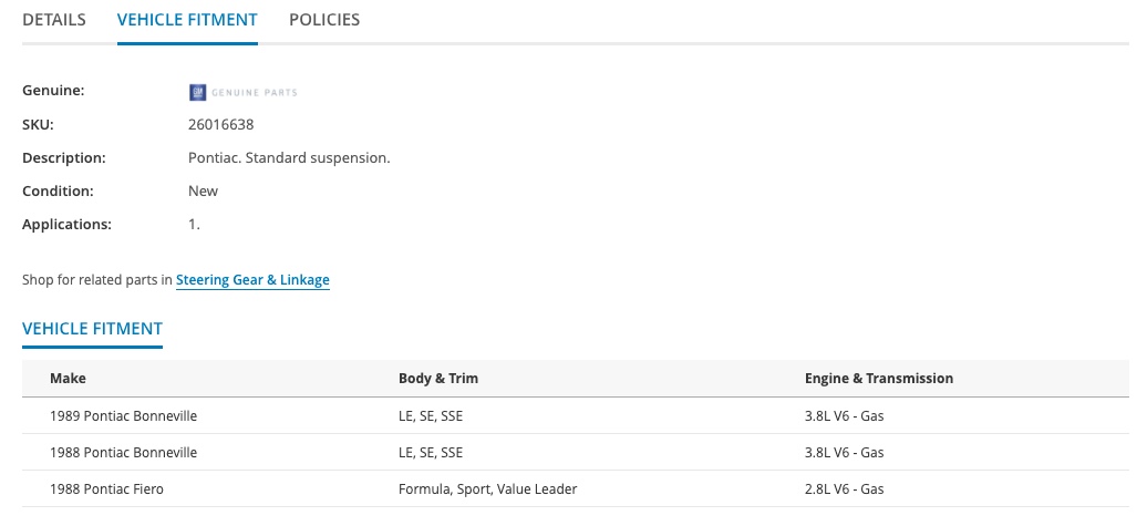

            And speaking of the above power rack - the GM parts site I grabbed that from, seems to think that it's for an '88 Fiero! As well as a 2 years of Bonneville.
  I'm sure someone's tested THAT theory over the years!

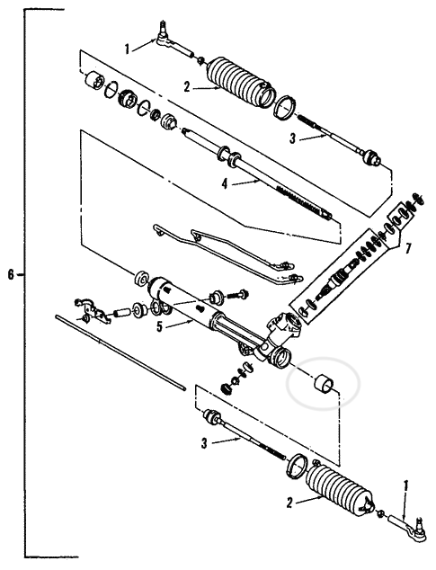

            So yeah, that is a separate sintered iron (that's what it feels like anyhow) bushing.   Heated up the end of the rack, and a few taps later it was out.
  Just because it's easier than searching forever, guess I'll make a new one.
  I mean, they don't even have a number on any drawings I've found associated with it!   So to buy one is probably right out.
  Thinking 932 Bronze?
