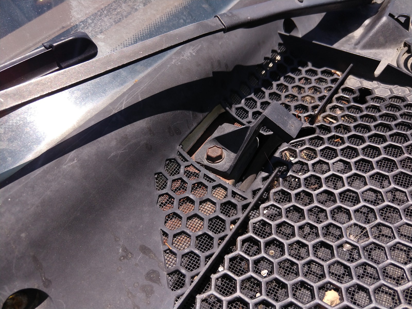

Well, kinda works. The nozzles are angled such that about half the washer fluid is thrown onto the roof. I think I need to angle them downward just a touch, but I'm afraid of breaking the nozzles, which don't look like a very common part.
Does anyone have experience adjusting the angle of the nozzles? I can see that bolt that attaches them and I might try to shim something on one side, but maybe somebody has a tip or experience with this problem. First I thought that the problem was more one of being stationary when using the washer, but even when driving quite fast I'm putting a lot of fluid on my roof.

DON'T ADJUST BY BENDING. They will break. (Ask me how I know.)
To adjust mine after I replaced it, I loosened the bolt holding it down shimmed the nozzle to adjust the aim. It's a trial and error process 'til you get what you're happy with. Shim the front to make the spry hit the windshield higher. Shim the back to make it hit lower. When you've hitting where you want, trim the plastic to the contour of the washer nozzle.
BTW, I used thin plastic sheet but you could use aluminum foil or thin, sheet lead flashing material. You can cut both with a sharp utility knife and they won't rust or compress when you tighten the bolt.
