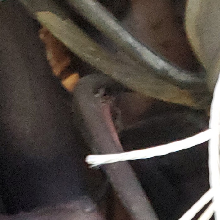

Here is what the frayed cable looks like. The pink part is all intact, just the bottom where it first comes out of the shroud got a bit melted.

Basically, if you can manually operate the throttle body by hand and it moves smoothly, you'll need a new cable. They're about $50 from the Fiero Store.

Can't really make out your photo. But I would agree its time for a new cable.
Its a bit of a pain to fish the cable through the passenger compartment.
