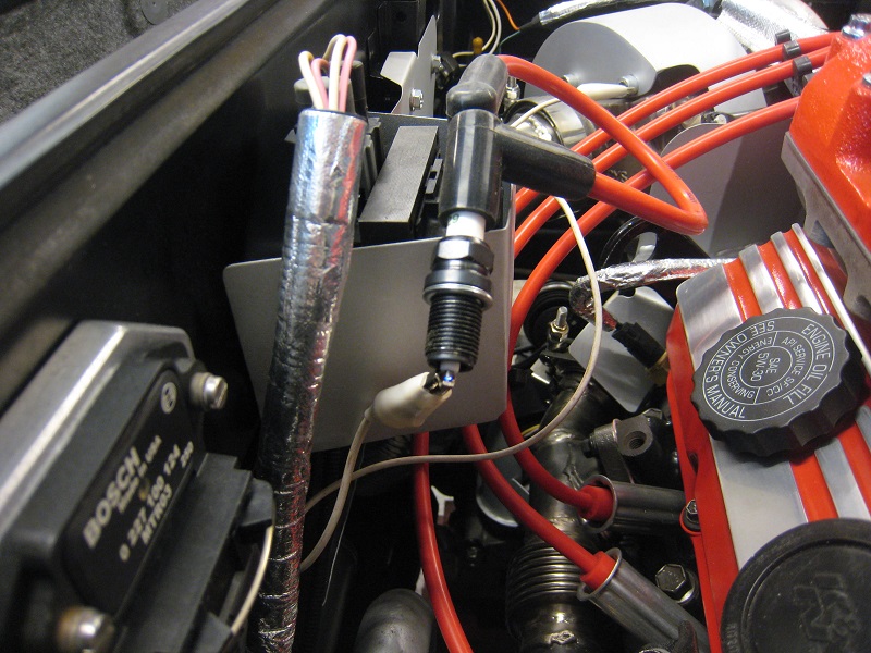

For instance, I tested that the ignition system would fire sparks:
You can test other outputs similarly (injectors) using the output test modes and such. Check that the inputs are all reading correctly, calibrate TPS, etc. Suck/blow on the MAP.

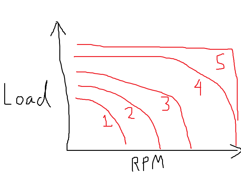

You can build up your tune incrementally. First, work on the idle area first. As you rough in that 1st island, extrapolate to the second, fine-tune, and continue outwards.
I would say that my engine saw its first boost after two hours of runtime (perhaps 4x half-hour tuning drives).
