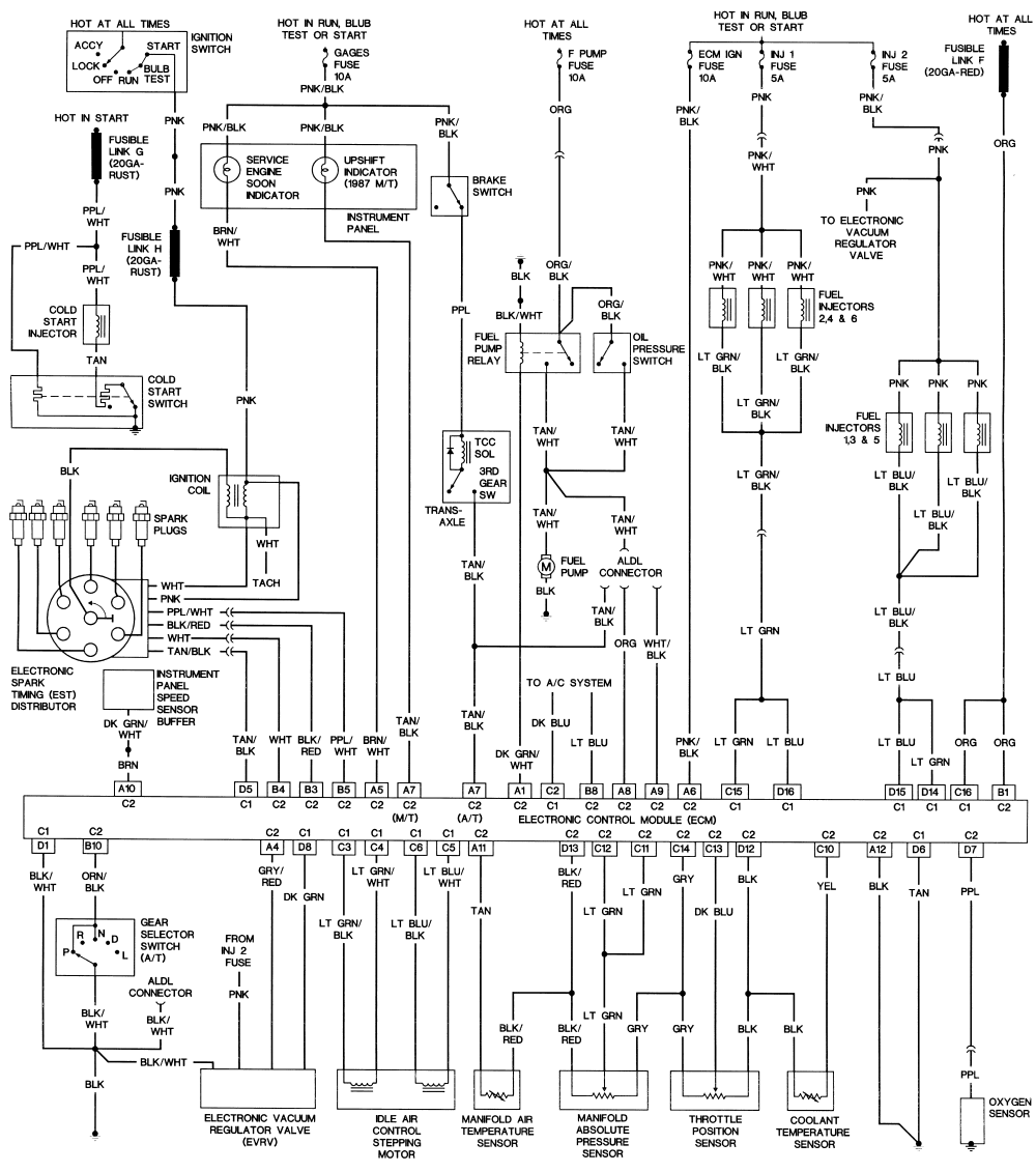

I need a wiring diagram I had a fire from a leak under the intake and had to take the whole loam apart to look for damage. It started and ran before the fire now it will only run on starting fluid.

I believe this is for 86...
Check your Inj1 and Inj2 fuses.
