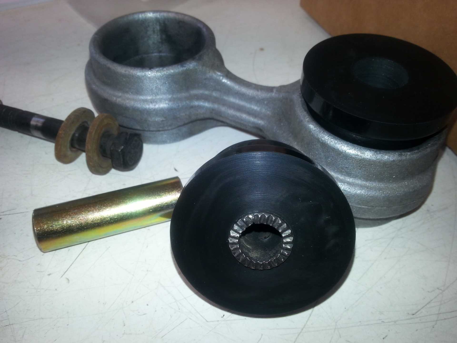

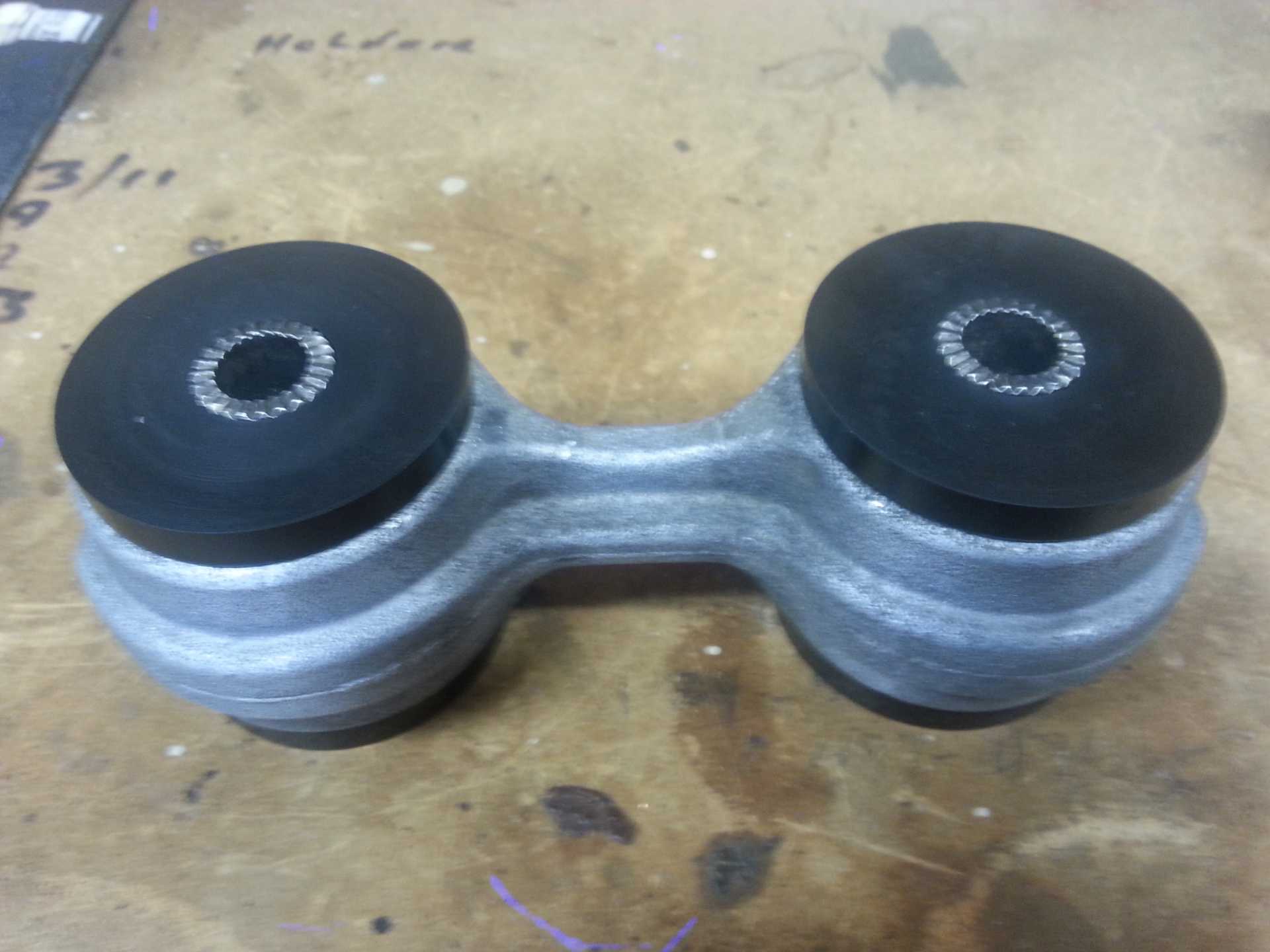

Is nice.
One issue is the bolts etc are Class 10.9 to handle the torque spec. The problem is almost no-one bothers to even try to look up the spec and treat as normal bolt.
Worse, Using a "standard" short ⅜" rachet handles etc is near impossible to torque them properly w/ OE tooth end sleeve. Then replace w/ cheap smooth pipe to replace the OE and will have problems. More obvious w/ slotted holes but can move and "wallow out" round holes too.
Far worse, some fools get polly lube, anti-seize, etc. on the hardware faces that make more problems. "Dog bones," Cradle sets and some others Do Not need "polly grease" because they won't move. When you use anti-seize, only "grease" the middle where sleeve live.
And isn't just "dog bones" but any suspension bushings w/ "upgrade" to polly.
Nearly All New Polly sleeve is shorter then polly hole. When bolts are torque right, think "they" indented the polly should compress to fit the sleeve. In a "dog bone" w/ big polly and often odd shape bracket can't compress and sleeve can slid easy.------------------ Dr. Ian Malcolm: Yeah, but your scientists were so preoccupied with whether or not they could, they didn't stop to think if they should. (Jurassic Park)
