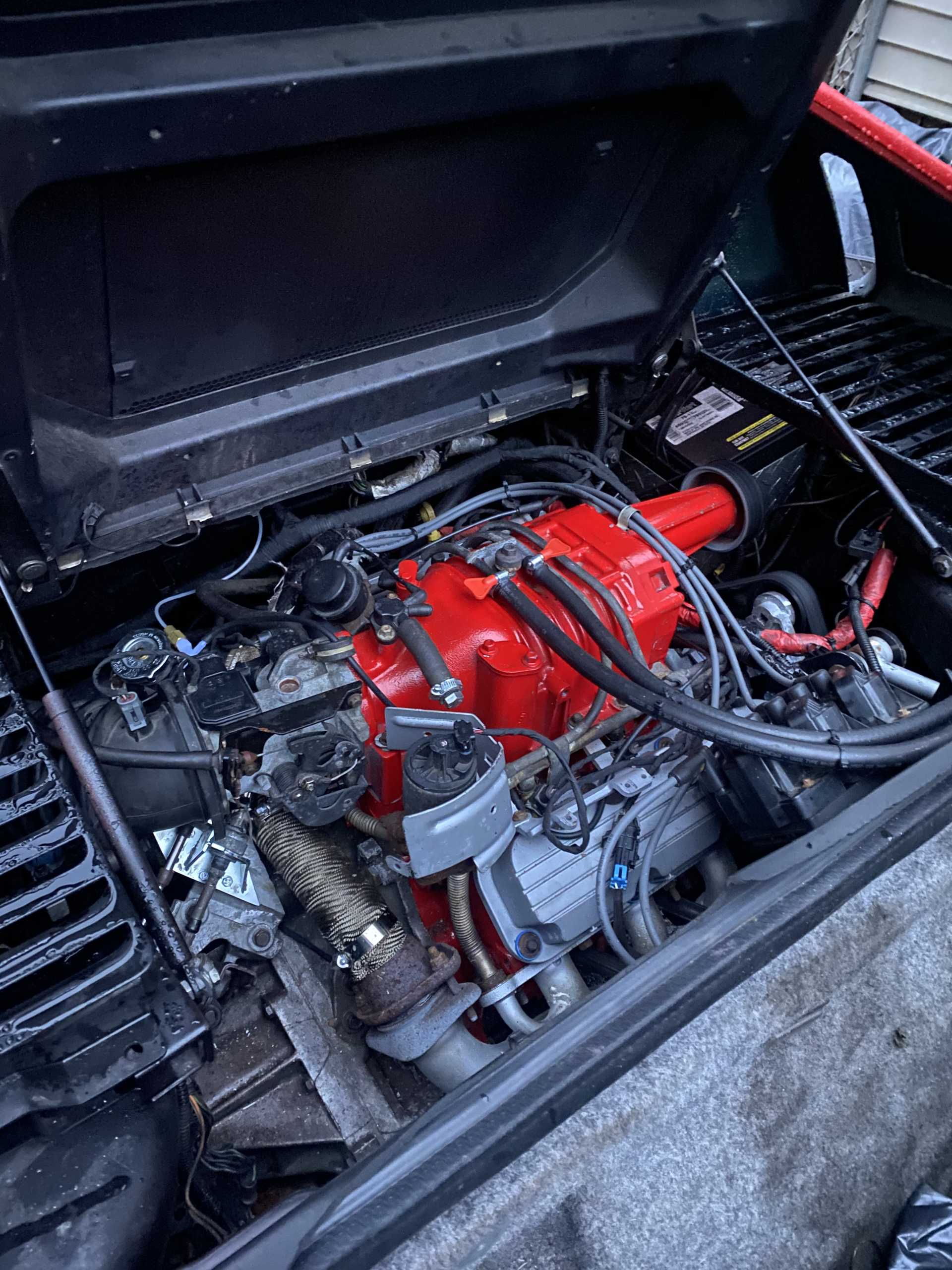

Ok here is my problem I got a 3800sc 4 speed fiero. Not running the fiero T stat housing using the stock 3800 one. I just installed a new 180 t stat water pump is new also, intake gaskets have been done with 04+ series 3 intake manifold gaskets so not the plastic ones. When driving the car it runs perfectly fine right at cool temps no over heating at all. When I’m idling or in heavy traffic the temp gauge creeps pass the 220 mark. Stock fiero fan using a Derale adjustable fan switch screwed into the lower intake manifold water outlet so I know that it’s accurate. If I read the scanner I can see it getting to 220 that’s when I have the fan switch turn the fan on. It will stay on but the temps won’t come down it will just keep fluctuating. Soon as I drive off or rev the motor the temps come right down does this sound like a air pocket situation? I bled the system from the back keeping the bleeder open car jacked up til all air came out. Overflow bottle up front is half full also When warm.

You maybe 100% right on this fan is coming on after it gets passed 220 degrees I’ll lower the adjuster on the controller while looking at the scanner and dial it in to come on at 200 degrees and turn off at 180. I’m also installing a non vented 16 lbs cap in the rear so I’ll have 2 of the same pressure caps hopefully this solves the problem
