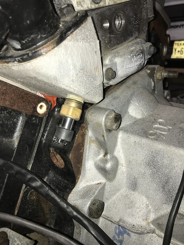

i have diagnosed my faulty temperature gage as being the sender. So i bot a new one. Looked exactly the same as the old one. i tried to quickly put the new sensor in the hole of the old one and it seemed to slip down into the motor. i put my finger into the hole and something appeared to move inside. So i tried the old one to see if it would drop down into the hole as well. And sure enuf it started to go down into the hole. What is going on here? What am i missing? Is there an inspection port for the flywheel that i dropped my sensor into?
So i used my flash on my phone to take a pic of the hole.

Sure enuf, there are two holes. Where did my temp sensor go? Down into the clutch flywheel area? Any ideas?

Yep. Pull the inspection plate/starter and see if you can fish it out. An extending magnet might help. but I am not sure the sender is made of steel. Brass isn't magnetic.

Great idea. With the inspection plate and starter removed (disconnect battery first!!!) a flex magnetic pick up tool may work. That's a magnet on a long flexible rod. I believe the sensor base is steel so it should work. . With a bit of luck it may come out. Might also try rotating the engine slowly by hand using a wrench, small prybar or big screwdriver on the flywheel teeth. Sorry to hear about the mistake but we all make them.------------------ " THE BLACK PARALYZER" -87GT 3800SC Series III engine, custom ZZP /Frozen Boost Intercooler setup, 3.4" Pulley, Northstar TB, LS1 MAF, 3" Spintech/Hedman Exhaust, P-log Manifold, Autolite 104's, MSD wires, Custom CAI, 4T65eHD w. custom axles, Champion Radiator, S10 Brake Booster, HP Tuners VCM Suite. "THE COLUSSUS" 87GT - ALL OUT 3.4L Turbocharged engine, Garrett Hybrid Turbo, MSD ign., modified TH125H " ON THE LOOSE WITHOUT THE JUICE "

Thanks guys. The sender is not magnetic. Some have suggested using hot melt glue on a stick. i managed to move it using a bent wire. Didn't spend much time trying. Gonna try more tomorrow. Jelly2M8 sent me some pics of a spare motor he has and it appears that there is no way for the sender to fall down to the bottom where i can fish it out by removing the dust cover. Sooooo i have been looking for my hemostats.

The hole is round, and is indeed threadless. Why is it there? Dunno, but it trapped me. i wud never consider leaving it there. i spent 1200 canuckbucks on my flywheel, machining and clutch, and bolts. Allowing a 40$C sensor to damage them is a no go.
i have now separated the block from the tranny by about 1cm (3/8") and still cannot see the sensor. My wife claims she can feel it. So i will let it sit for a while to let her try again. The block and tranny are being held in alignment by 5 long bolts. It took me 7 hours to drop the cradle and slide it out to the side, including over an hour to get the front cradle bolts out. I have no rust on my car. It will probably be 12 hours or more to reinstall the cradle and hook everything up.
