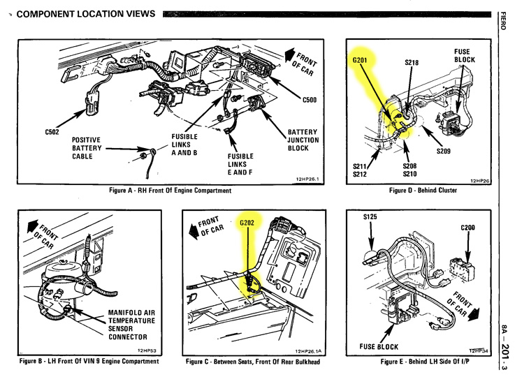

Trying to wire up my indicators for the oil, water, high beam, and cel lights. I have everything powered but the switched ground doesnt come on for any of them. I have the fsm diagrams and everything connected to the right wires but no workie. Is there some relay that controls those that might be fried?

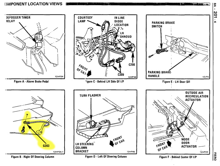

Check the grounds (highlighted)
shemdogg
JUL 17, 11:49 AM
Thanks man I just had some wires switched. Putting in new gauges, got most of it working. Down to the coolant and oil indicators, have the right wires, now have to check the senders.
