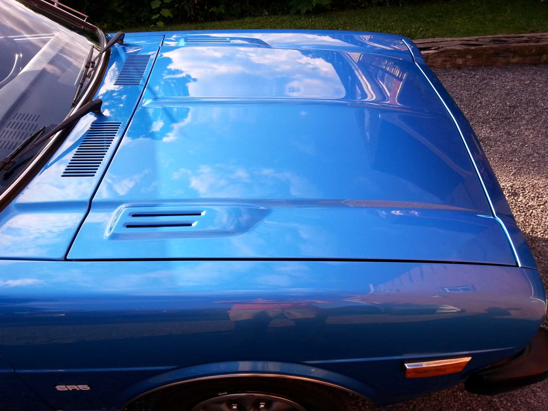

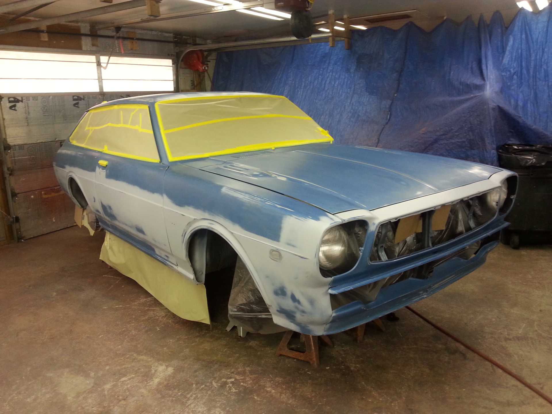

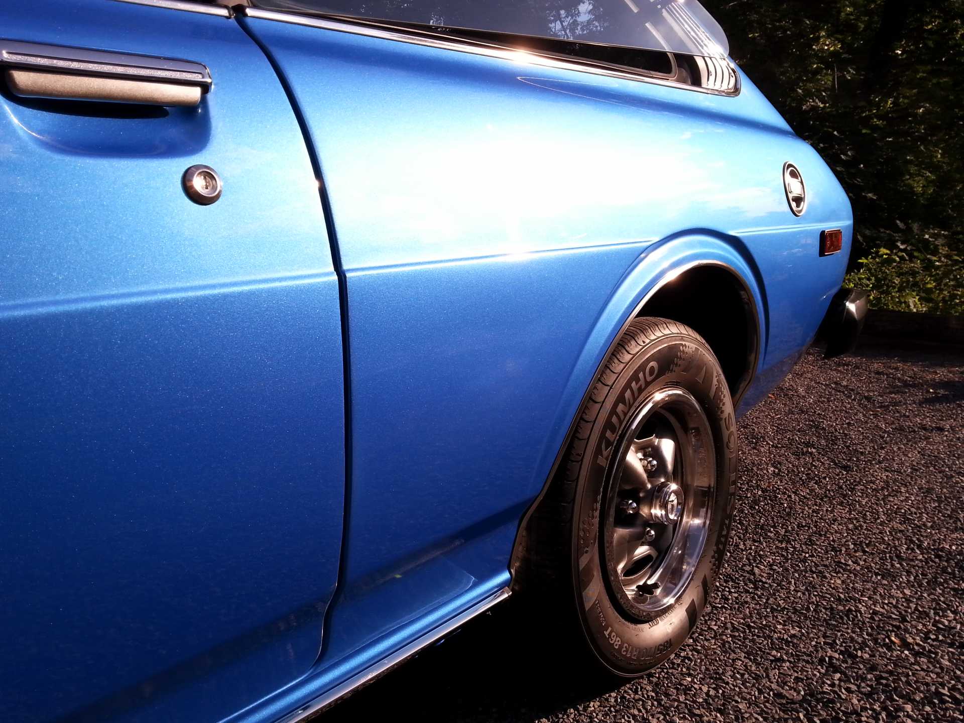

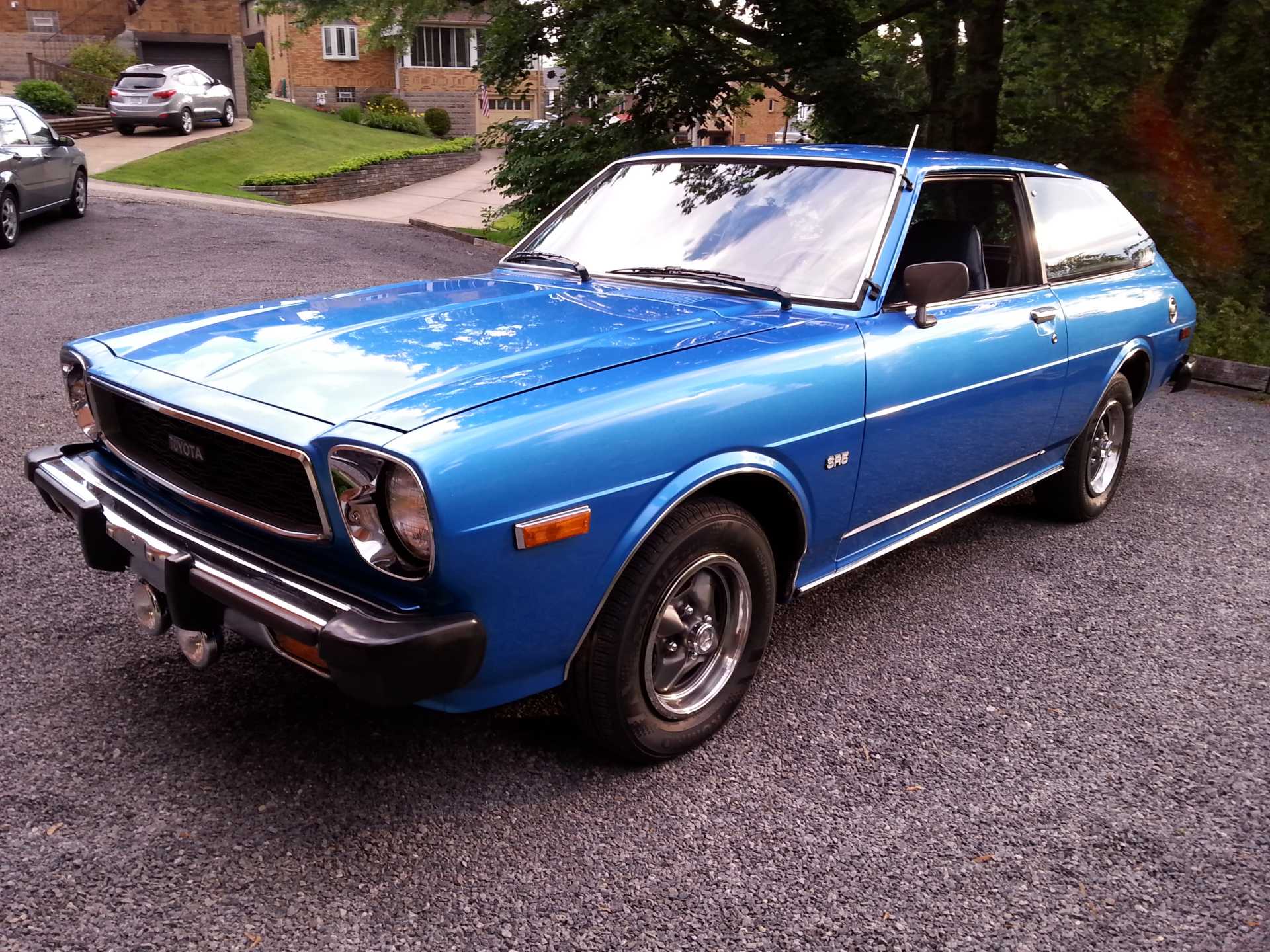

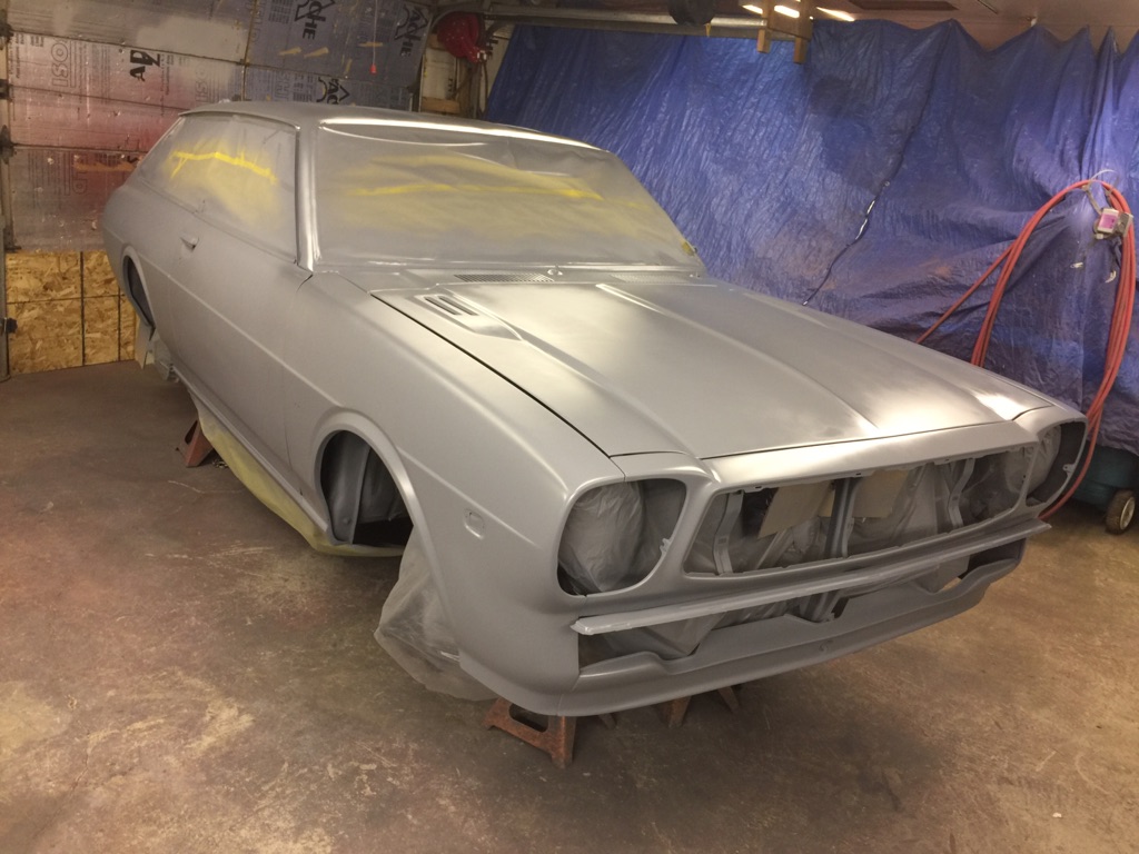

If you're going with a solid color like yellow I would recommend single stage urethane, its basically base/clear already together, application similar to single stage enamel, less materials and cost less. I wouldn't cheap out on the brand, not worth it after all the prep work, the old saying goes... for a nickel more you can go first class. If you're trying to cut costs use the PPG Shopline.
Personally I like Metalux, its not available retail, its in-house supply in body shops, you have to know somebody. Its not urethane, its polyester, so its not as hot, easier to work with. My last car I painted in 2017 was first time using Metalux and it cost HALF of what PPG would have cost me (total cost for all supplies was $700 vs $1400) and loved the results. Here is finished product...
