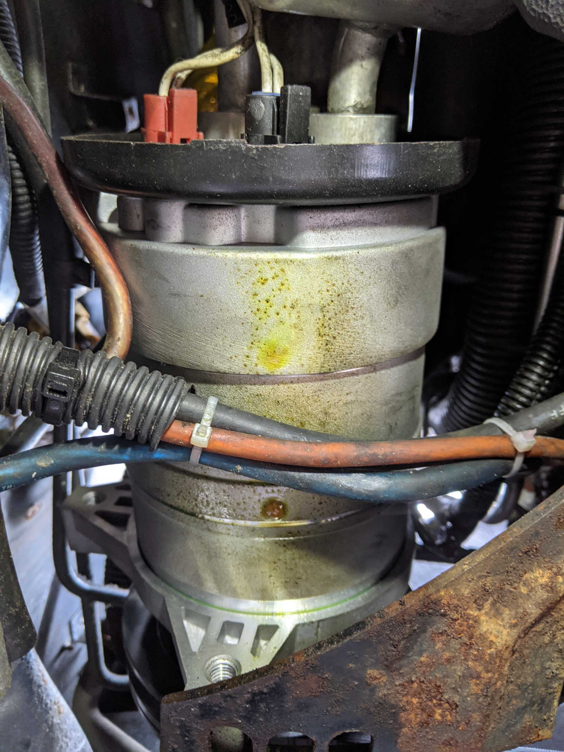

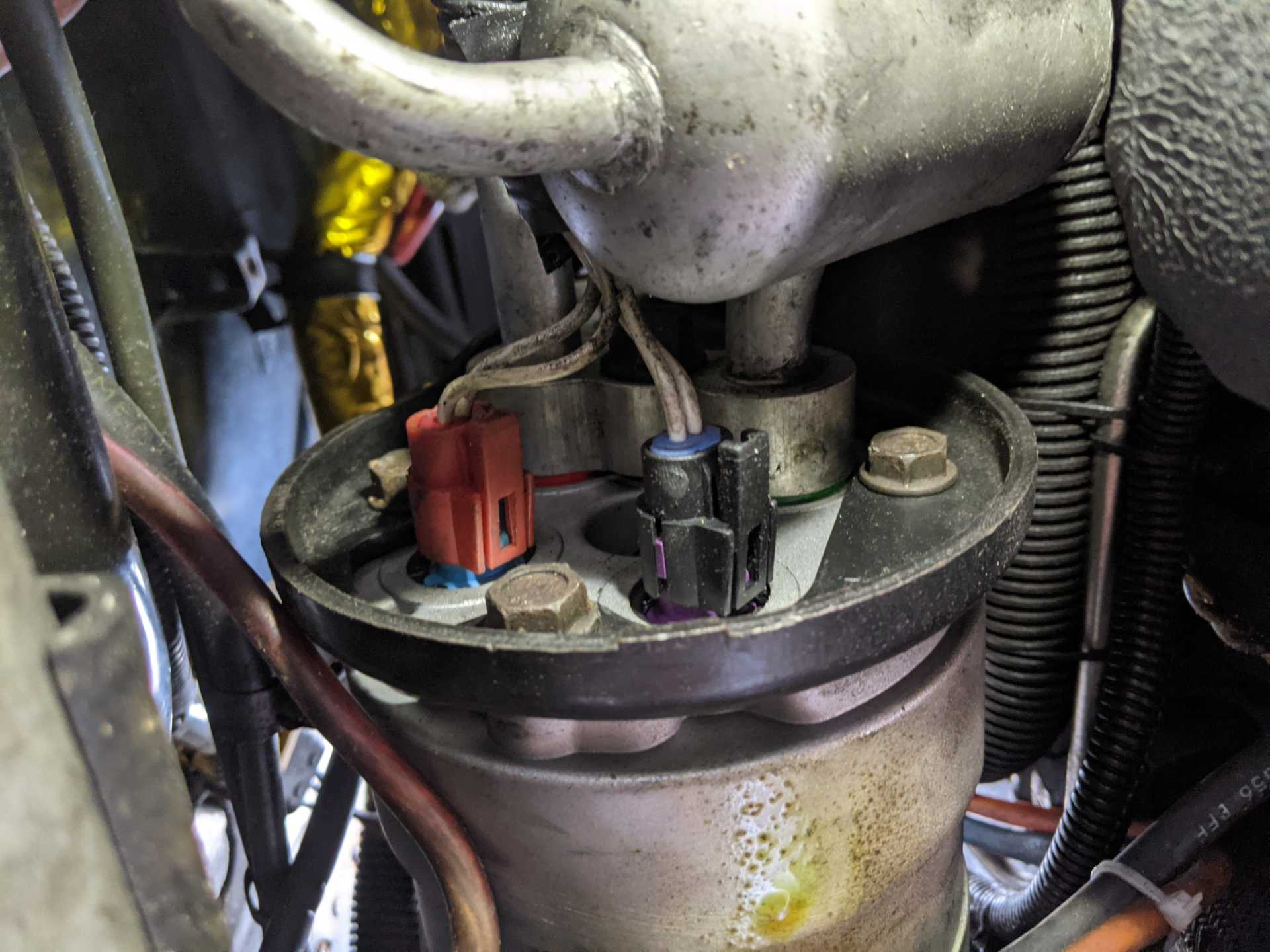

I'm not seeing oil leaking at the hoses or at the shaft seal. It's coming out of the seams on the side of the compressor itself. When I looked yesterday, I could actually see the oil bubbling out. I'll see if I can take a picture when I get home. I think that part of the compressor is sealed by some big orings in the case. I'll take a close look at the hoses/block when the new compressor comes in, thanks for the info!
CharginPegasus88
JUL 21, 05:08 PM
Here are some photos of the compressor in the car. The end near the pulley and end where the hoses go in are clean and free of oil. The oil seems to be weeping from the seams on the compressor case itself.

The main problem with remanufactured parts is the people who are doing the work are just people looking for a paycheck and the training is limited to just replacing common parts that are the usual culprits on what ever part they are rebuilding. This means if there is another issue with the part it does not get corrected because the person does not know what to look for to identify any potential issues that may soon occur.
