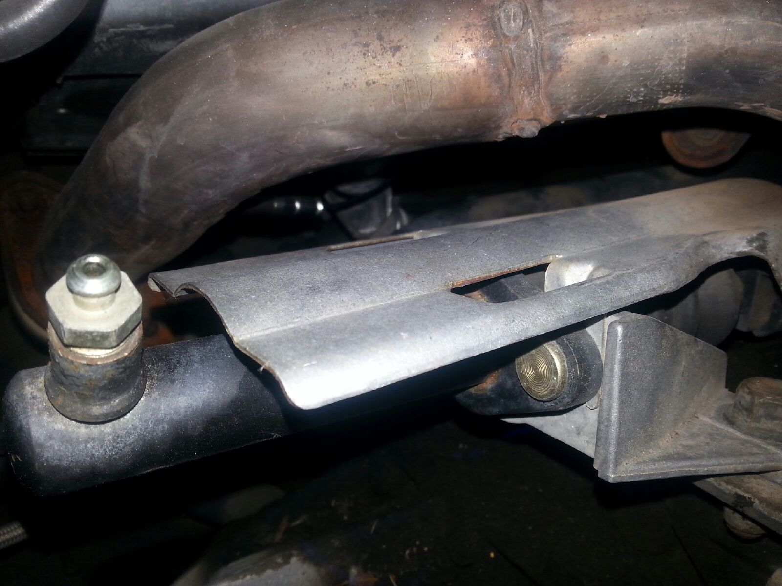

I replaced the slave cylinder on my 88 GT about 15 years ago with no problem, but I'm looking for some guidance on replacing the slave cylinder on my 86 GT, because I'm staring at this thing and can't remember/figure out how it unbolts! How do you get to the closer nut under the heat shield, or how do you get the heat shield off?

That shield does present a problem on the 4-speed. Try to get the forward nut loose. From the front side, you can usually get to it with a wrench. That part of the shield is usually slotted. The one nearest in the photo will require a deepwell socket and maybe a flex head ratchet.

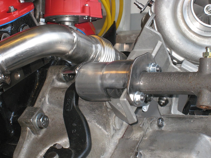

Rodney's slave has threaded holes for the studs, and the studs are kept from turning with threadlocker.
I suggest unscrewing the studs, and using long-ish bolts inserted through the bracket, threaded into the slave cylinder to fix it into place.
Then, slip the heat shield onto the excess bolt length that sticks out beyond the slave cylinder.
Secure the heat shield using nuts.
I have a different heat shield as I have a modified exhaust, but I think the same idea would work with a stock heat shield. It would solve the apparent assembly issue.

That looks like a Getrag slave. Is it? The 4-speed Rodney mount I have looks nothing like that. For the heat shield, I simply clip the flange so that rather than having a hole, it becomes a slot that can be slipped down over the studs just before doing the final tightening. [This message has been edited by fierofool (edited 07-28-2021).]

That's a cast iron Rockauto slave cylinder for the Muncie 4-speed. I did wise up and buy a Rodney Dickman slave afterwards, which is made of aluminium.
The mounting bracket is the stock aluminium bracket that comes on Muncie 4-speed Fieros. Rodney Dickman makes his mounting bracket from pieces of steel welded together.
