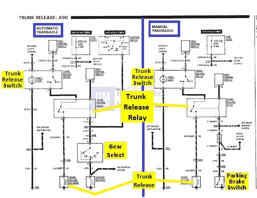

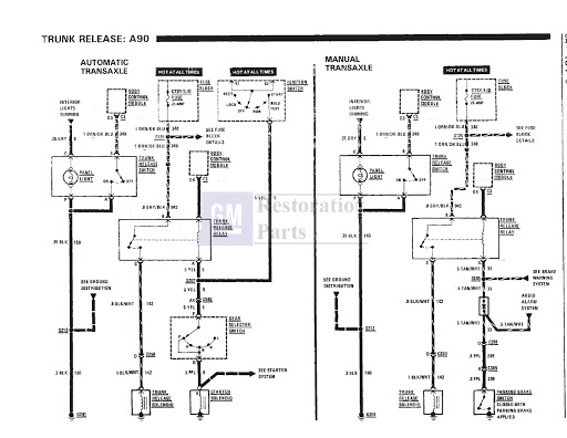

Hey Kevin; I have a 1985 and a 1988 service manual, and also the Haynes manual......The trunk release wiring is pretty simple- power to the switch, which then goes to the trunk release Relay......There could be a problem at that point- either an automatic trans needs to be in "Park" to allow actuation, or with the manual trans you need the Parking brake set (Although I do not have to do this)
The only other possible problem is that the Fuse should be checked (Courtesy/Lid)
Here is a "Improved" version of the diagram...

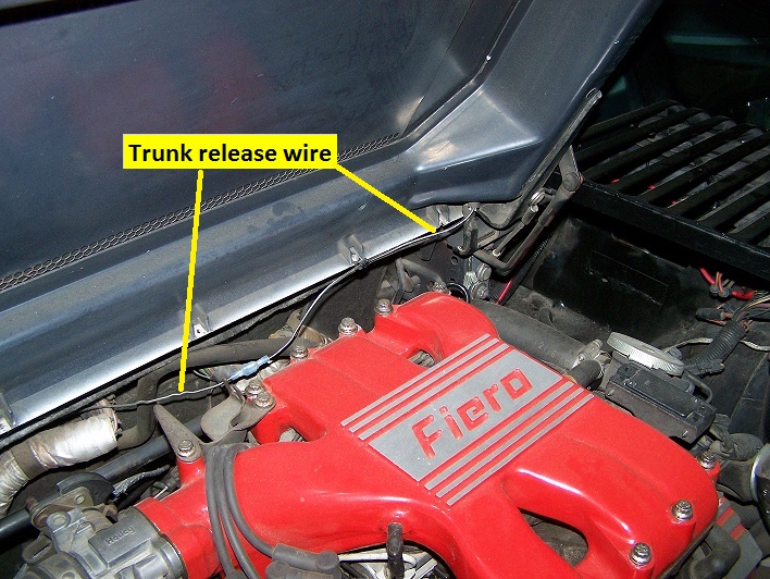

So if that is the only issue, it's 1 wire to the solenoid that is black and the connector for the one wire should be at the driver side decklid hinge on the 85.

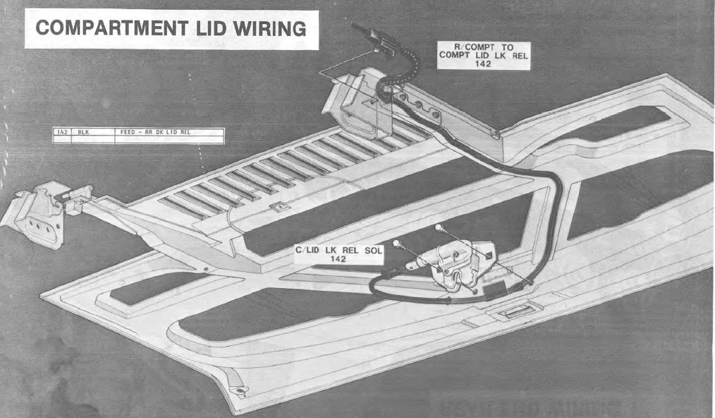

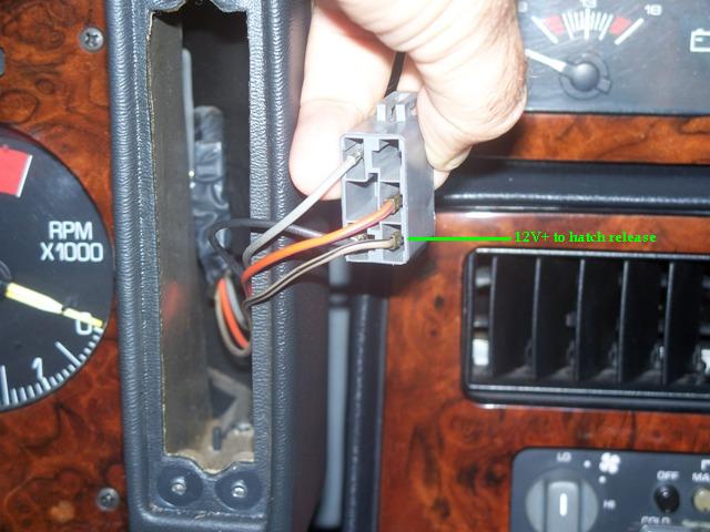

OK- After a while I can usually "Comp-Re-hend" what others have written. Here is some pics...BUT.....I swapped my Notchy lid for a 86-88 GT lid...so this may not solve your problem. Critically, the trunk release wire is black and white striped.
