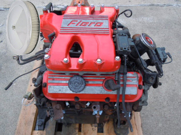

So it looks something like this?
 [This message has been edited by IMSA GT (edited 08-24-2021).]
