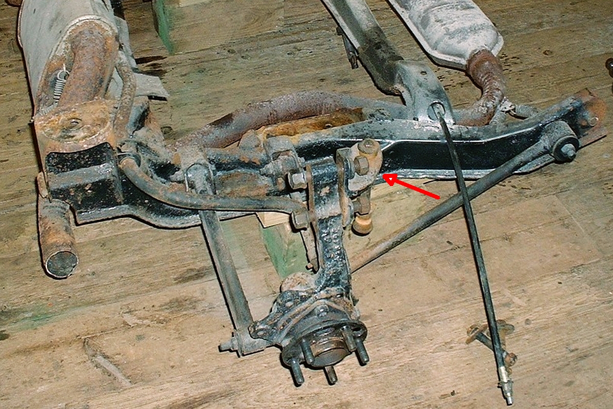

So my 1988 Mera I find does not have a rear sway bar; explains why it corners so squirley. Can someone post pics of where it attaches to control arm? I searched here and internet but can't find pictures of 1988 suspension, only 84-87.

No. On an '88, the ends of the rear sway bar don't attach to control arms.
There've been plenty of photos posted here of '88 GT and Formula rear suspensions. Here's one originally posted by Bloozberry. I've added a red arrow to indicate the bracket that the rear sway bar's end link attaches to.

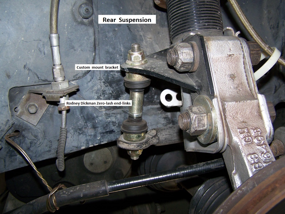

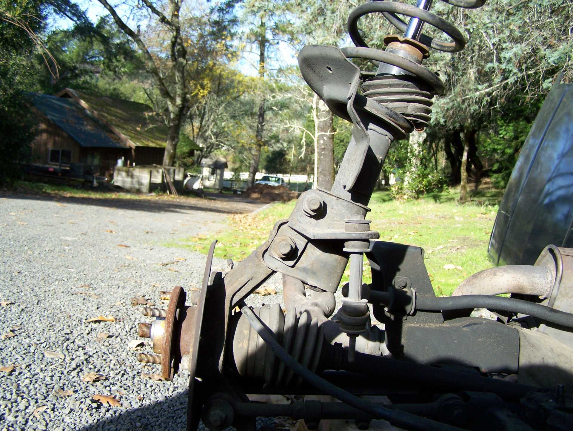

I have some pics of both my custom (Slightly) brackets and stock brackets;
Stock bracket;
My custom bracket;

Thank you for the detailed pictures, mow I understand where it gets routed in/around the cradle. The mounting tab on the strut is gone so it was intentionally left off. I need to jack up the car and see if the exhaust is in the way and the reason for no sway bar.

Keep in mind that only the '88 GT and Formula came from the factory with a rear sway bar. If your Mera was built using the chassis of a base model '88 (was that done?), then it never had a rear sway bar.

So, in these photos, one shows RUBBER dampers on the sway bar ends, the other, shows what looks like cream-colored NYLON dampers. Which is OEM correct? I've seen an 88 with those nylon dampers all crumbling away. I would think that the rubber ones would last longer.
Also, I've read some people say to tighten the washer until is just touches the rubber. Others say to tighten enough to compress the rubber. Your advice? Service manual does not specify which.
Vintage-Nut
AUG 20, 01:24 PM
Cream-colored NYLON dampers were OEM and yes; my nylon dampers were crumbling away.
As cvxjet photo, I too bought Rodney's Zero Lash End Links on the front and the rear........
