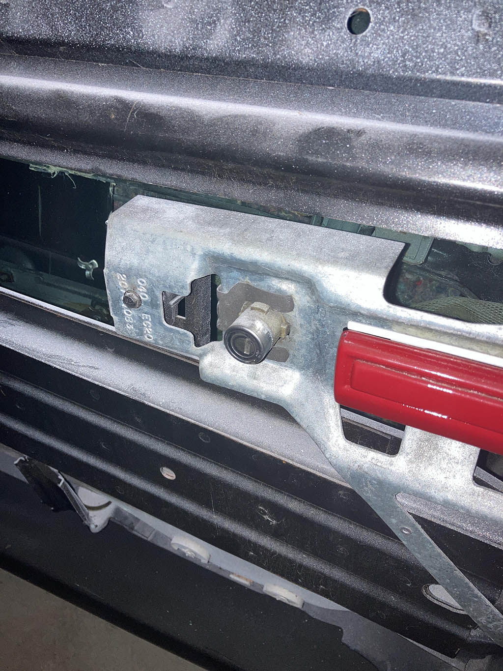

The handle will need to be removed anyway in order to remove the door skin. Here is a picture of my car I just took for you. My car is a little different as I have removable door skins held on by DZUS fasteners so I had to customize the panel so the handle stays on the car when I remove the skin. In your case, you'll need to remove the handle.
