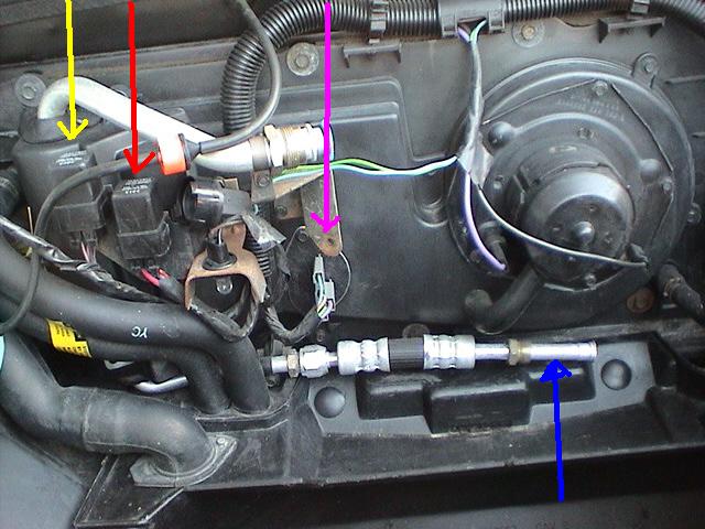

If the blower runs fine with the heater off and it also blows cold air when the AC is on, it may be an issue with the heater resistor. It is in the front trunk along the firewall and is indicated by the purple arrow in the picture.

It would be a good time to check for a mouse nest. The heater resistor can be trouble.
The resistor only play a part on fan speeds 1,2,3. The resister is bypassed when you have the fan on the high setting.
and funny. I think that is one of my pictures. I'm glad I'm helping out, even if I'm not around.

I had to "borrow" it

quote | Originally posted by IMSA GT:
I had to "borrow" it  |
I feel good that I even recognized it. Please "borrow" all that you can to help everyone you can.

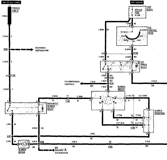

Can someone show me that schematic? I don't have access to that readily available to those anymore.
