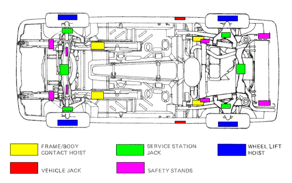

I was going to offer some help, but my '88 is built somewhat differently than your '87. I still think that you might be able to jack up the car and look at the way the cables are connected in the cradle frame. There is a nut in there that allows for adjustment. If it's been a while, you may need to spray the adjusting nut with penetrating oil to free it up. I was able to adjust mine easily with two small crescent wrenches. The piece connected to the cable has a square spot on it that allows one to hold the cable from twisting while using the other wrench to tighten the adjusting nut. Make sure that the cables going to each rear wheel are installed correctly and that the lever pieces to which each cable is connected can be moved freely. You can put a pair of vise grips on each of them and make sure they will pivot. There will be spring tension against them. You will see the spring when you pull the rear tires and examine the system. Please be careful, putting jackstands in the right place and leaving the jack in place too as back up for safety. I have attached am image I got from someone in here (thank you) so you get an idea where it is safe to jack up your vehicle. Good luck...
