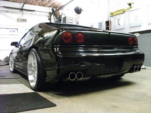

I currently have a modified my tail light panel and they are painted. While redoing them for a fresh paint job i noticed that after sitting the primer has cracked. I know this is a common problem and i was wondering if there was some kind of spray like a 2k epoxy primer that might stop this from leaking into the new paint job. I really do not feel like remaking my panel
any ideas ?

thanks for the suggestions, how ever its not the paints that cracking its the actual acrylic. Need something to stabilize the surface. Going to get my painter to put a few coats of clear and see it that will hold it [This message has been edited by nosaint (edited 10-18-2021).]

It sounds as though the paints/primers that you are using are attacking the plastic. In such a case a sealer may help but you are working with 30+ yr old plastic and the cures for aging may be few.
