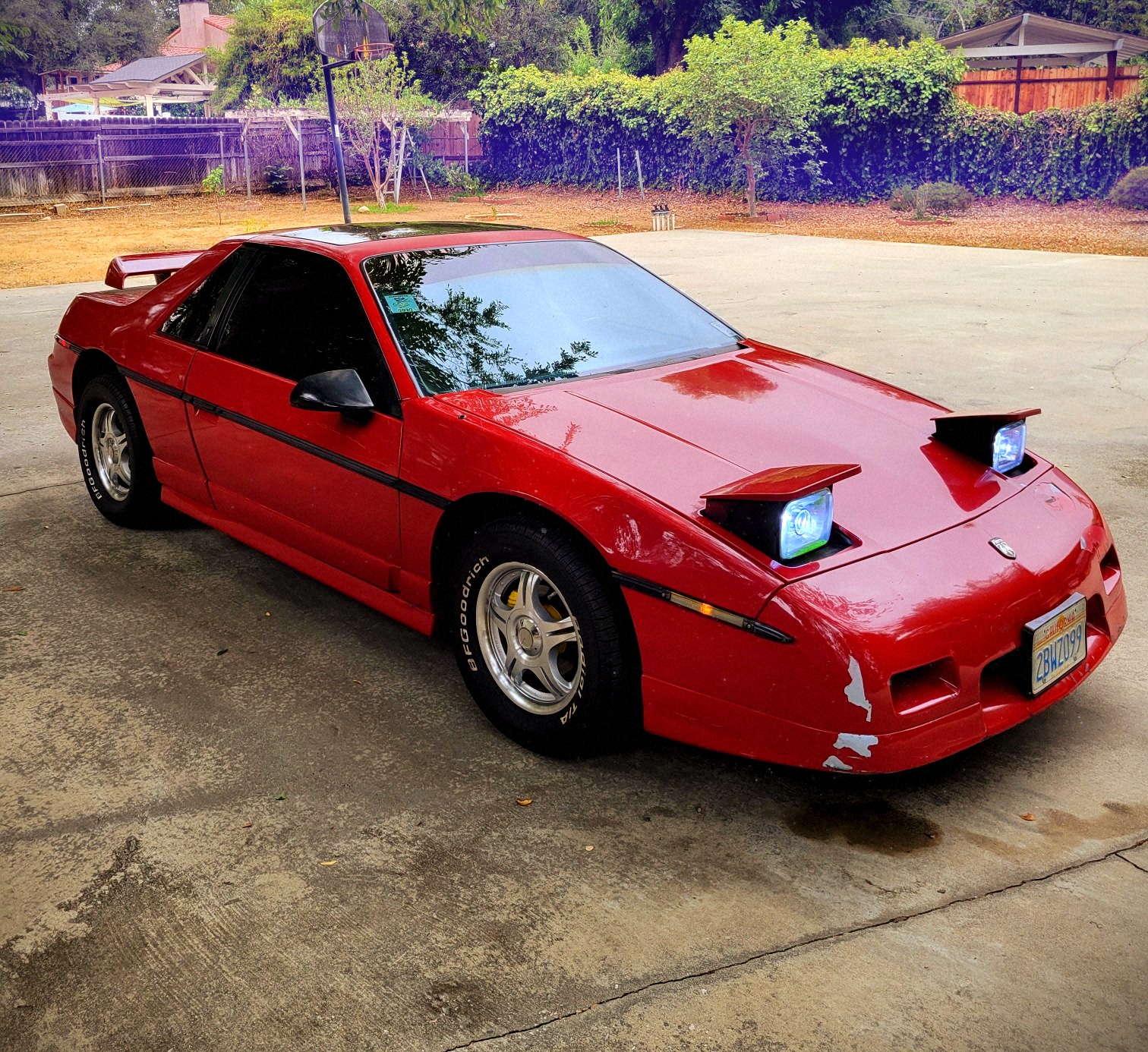

I'm 19 and have an 85 Fiero in my hands, its got the v6 and I've been thinking about converting it from a notchback to an 86 GT fastback and even toying around with the idea of swapping the front bumper with a formula or SE front end. I don't think I've seen it done before so I was curious if it was even possible.

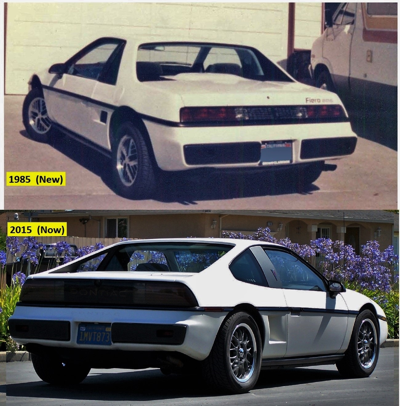

Yes- I converted my 85 SE V6 to 86-88 GT rear and 87-88 Base nose......Just bolted on...The only (Minor) problem is the rub rails don't all match...

Yes- I converted my 85 SE V6 to 86-88 GT rear ...Just bolted on.

cvxjet
OCT 18, 12:35 AM
I did not have any problem except some of the mounting "blocks" had to be re-filled with epoxy because they had cracked epoxy (Hmmm- my "overhead" is cracked....)
I ordered my car in April and took delivery in late May.....
Everything on the car works well....Except the "loose Nut behind the wheel" (I did fix the DIP in the Driver's seat....Had webbing installed across the bottom)
And I like your car also- Especially the paint color.....
