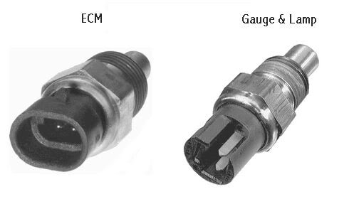

Edit: Found out a previous owner had the ecm sensor and connector were installed where the gauge sending unit is supposed to be. Will this not work? Do I need to revert back to the original sending unit? I also just tested the connector for voltage and got 12v. I've read it's suppose to be 5v! What does this mean?[This message has been edited by WaterInYuhDish (edited 10-26-2021).]

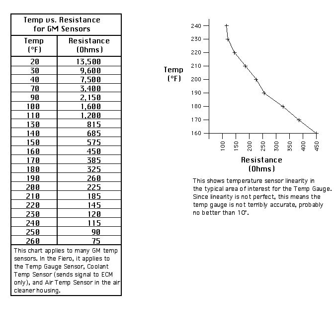

 Buy an appropriate resistor that matches one of the resistance values in this chart, near a 145 ohms resistor would probably be best, and ground one of the wires to ground with the resistor in between. If it is not close to the temp it shows in this graph for the given resistance, then either the gauge is bad or the wiring to the gauge is bad. Also keep in mind that one of the wires is for the overheating light, and the other the actual gauge.
Also make sure you are using the right sensor. The correct one is the right one

The ecm sensor has been being used where the gauge lamp sensor should be... Lol I even talked to Napa about the difference and they still sold me the wrong part. Haha I really hope this is it.

Yep, thats actually exactly what happened to me. Previous owner even changed the connector for it to the ECM version. Im pretty sure the fiero store sells the connector if you need it.
Edit: heres the connector https://www.fierostore.com/...px?s=65488&d=172&p=1[This message has been edited by Xenoblast (edited 10-25-2021).]

Rock Auto carries them. Standard Motor Products PN TS168.

Warning: Many Charts showing Ω vs Temp are for ECT for ECM and NOT for the Dash Gauge. While both can use NTC Thermistor, the Ω Values for each are way different. ECM needs a different Resistivity Curve to cover Way Below 0°F to near 300°F to run the engine right. ------------------ Dr. Ian Malcolm: Yeah, but your scientists were so preoccupied with whether or not they could, they didn't stop to think if they should. (Jurassic Park)
Thats probably true but I can vouch for this list, I used it when I was diagnosing my temp sensor and it was spot on atleast for 220 degrees
