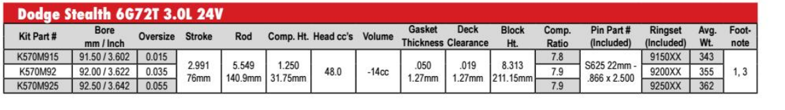

I do have a question for those that know more about engine building than I do. I have read that Wiseco K570M92 forged pistons from a dodge stealth will work on a 3.4 block. 0.035 oversize is the same diameter as the 3.4 at 92/3.622 and I have done some research and read some people have used these in the GM 3.4 60 degree for boosted applications. I have read that it drops the compression ratio to 8.2.1 when used in a gm 3.4 60 degree which is also fine since its boosted and stock compression is 9.1. can anyone help wth comparing the specs of the stock 3.4 to see if these would work for me? specs from wiseco:

JJ, don't take it personal, patrick is an engineer and he is just trying get you the best answer by asking questions. Besided what Patrick mentioned the Steath piston is going to be about .214 inside the hole. That is by subtracting 1.464 comp height of the 3.4 piston minus 1.250 of the Steath piston. That means that with 50cc iron heads you'll have 7.0:1 comp ratio and with 23cc aluminum head you'll end up with about 9.49:1. Now, then comes the weight of the pistons. Wether light or heavier you'll have to get the rotating assembly balanced to those pistons if you want to do it the right way. Hope this helps!
