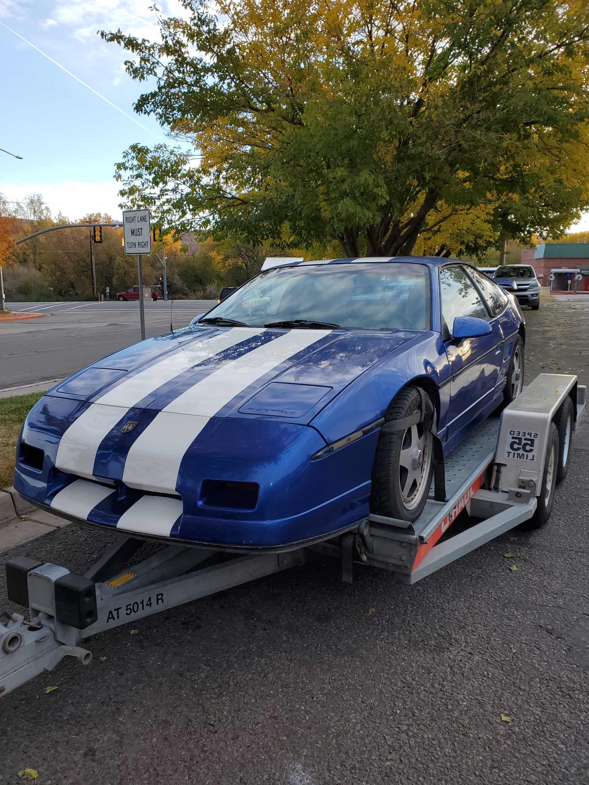

          | Hello, I just bought a 1987 GT with a 3.4 upgrade,and 5 speed.
 There are a few issues to fix.
 On starts, all the instruments flash for about 20 seconds, and I noticed the park lights flash with it.
 Are there usual causes for that?
 I should note the tach is inop, and the water temperature gauge needle fell off. It has a added external water temp gauge laying behind the cluster. I am not sure if it works or not.
 Attached is a picture of the new project.
