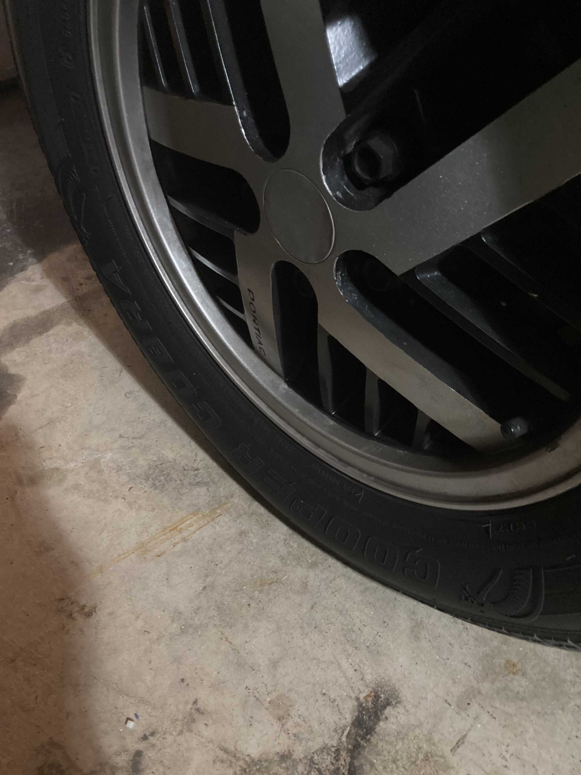

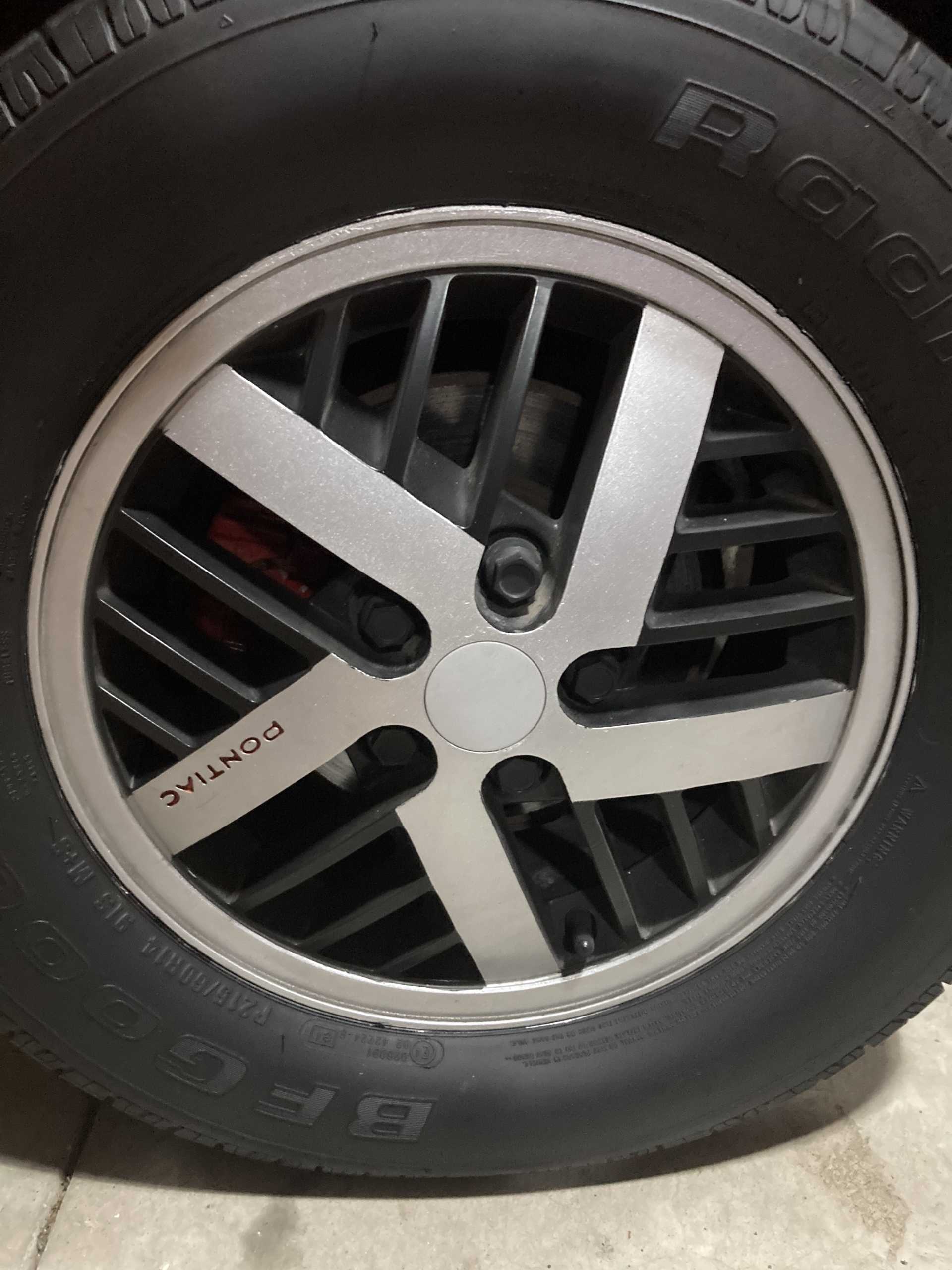

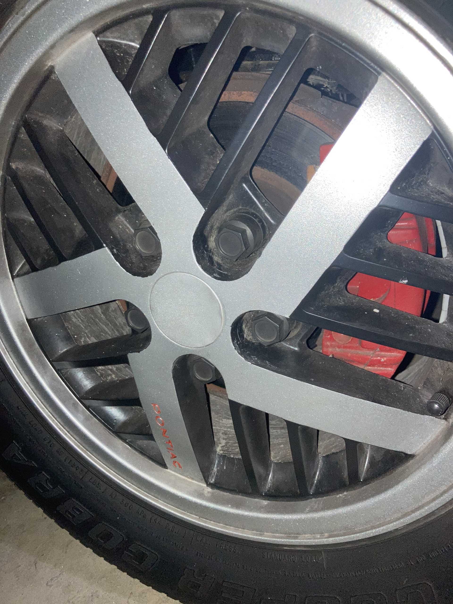

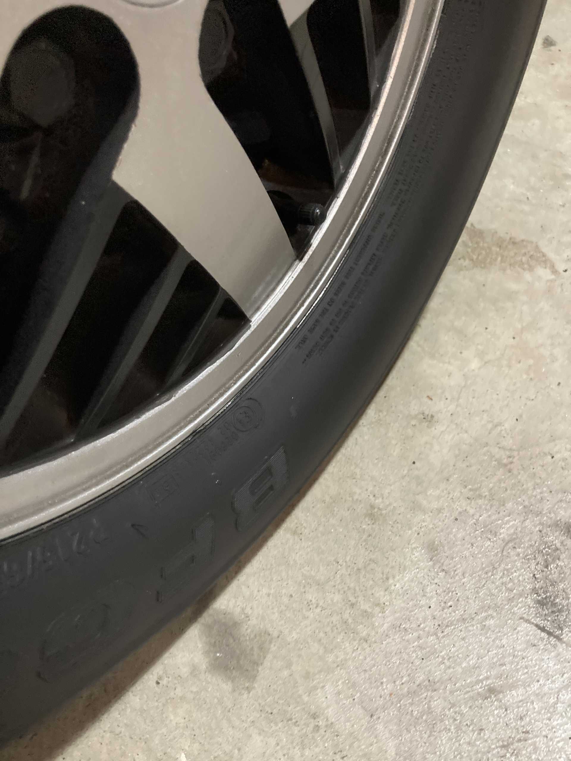

Hey Guys, What exactly do I have on this thing????
These are the wheels that are on the back of the car, I believe these to be incorrect, any guidance? and what they might be from???
It appears from what I can find here these are the correct offset with the extra "lip" and these are on the front of the car.....

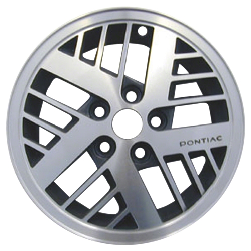

Pontiac Sunbird Wheel.
