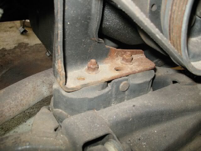

I did this a long time ago. You only need the 88 V6 U shaped motor mount and 88 rubber mount to install the motor on the cradle. The 85-87 L shaped mount is off like 1 3\4". No need to modify the cradle.

You can modify the 85-87 bracket and get it close. Extend it the end and redrill the bolt holes. This will have the side to side placement about 1/2" off from the 88, but the 88 2.8 engine U bracket was a 1 year bracket and can be hard to source.

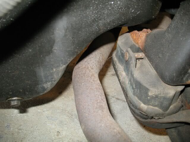

The 86 V6 exhaust pipe will be close to the 88 mount pad on the cradle, but can be made to work:

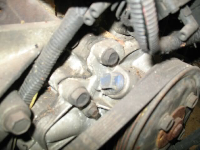

The 87/88 chassis only uses 1 heater hose connection at the engine. So you will need to remove and plug the heater core return on the water pump.
