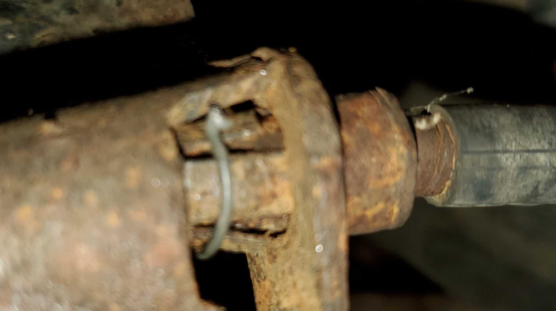

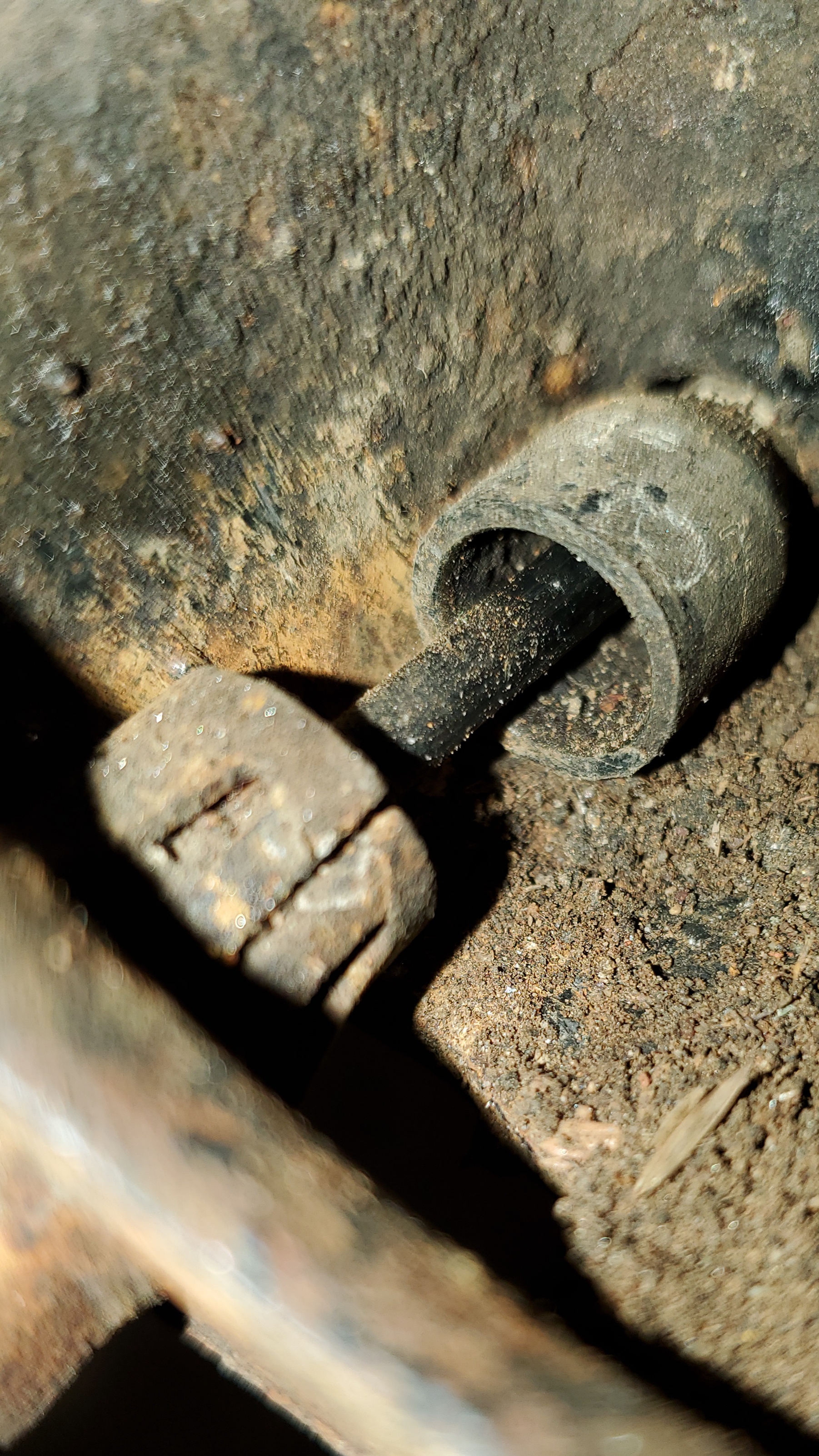

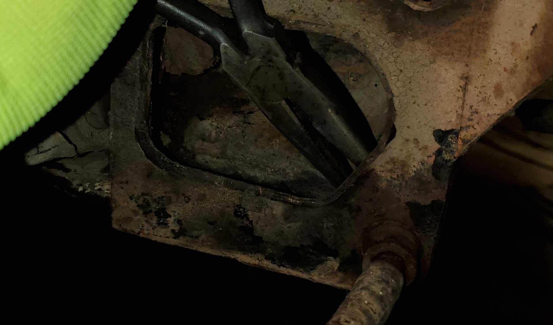

I'm looking to replace my clutch, and am in the process of dropping my 84 Duke's cradle in accordance with the alternate method that does not require dropping the engine: http://www.fierofocus.com/a...20Ken%20Campbell.htm I've done many of the steps besides the removal of the exhaust, tie rods, and drive axles, but I'm stuck on removing the parking brake cables from the cradle. I've tried the recommended methods like the hose clamps, and I just can't get the damn things loose! The three parts just will not depress, and being inside the cradle I can't access it and it's difficult to get anything in there. I've also tried needle nose pliers on recommendation from a friend with lots of wriggling, and twisting wire which broke off on the clamp.... Here's some pics:
 How it looks
 From a hole in the bottom - broken wire...
 Outside view with needle-nose pliers
I'm considering just cutting the cables at this point but I want to avoid that if at all possible. What methods have worked for you guys? Really just want to get the new clutch in and it back on the road...

Take cable off/out of caliper bracket. If have rust/dirt under ears, remove w/ small screw driver etc. Then compress ears w/ close end wrench, small screw hose clamp, or whatever is handy. I used 1/2" copper tube fresh cut w/ pipe cutter w/o reaming the tube. (Cutter shrinks very end and you need that doing this.) Or tube squeeze down a bit or oval shape.
But very likely wheel cables are iffy to bad... Pull on cable jacket and watch the ends. the crimp ends should be solid to the jacket so can't move.

842, the idea of tightening down the wire by twisting suggested another approach to me: zip tie. Place the tie as close to the end of the tangs as you can, leaving just enough space so the tangs will slip through the mounting hole before you have to snip the tie.

I'm sure some will not like my answer. I normally break them off. Get under them with a small flat screwdriver and bend them backwards until they snap.

Lisle makes a tool that slips over the cable and slides over the end of the sleeve to collapse the tabs and release the sleeve from the hole. The part number is 40750.
