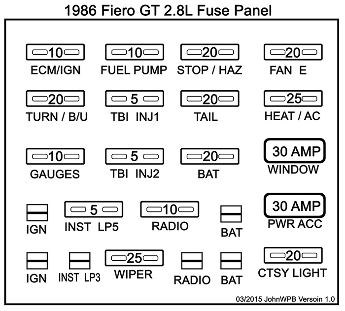

I think I am going to install a front camera on my car and I have a good idea where I am mounting it and how I will route wires. The area I am having trouble with is where to tap into for power. I want to use this while parking to make sure I don't wreck the front bumper....so that said what do you all think the best power source will be?

The fuse box.......use one of the extra IGN sockets provided.

Thanks.....I guess I was over complicating it by trying to think of a good power source under front hood....never even considered running it back to fuse panel. [This message has been edited by ceverhart (edited 12-29-2021).]
