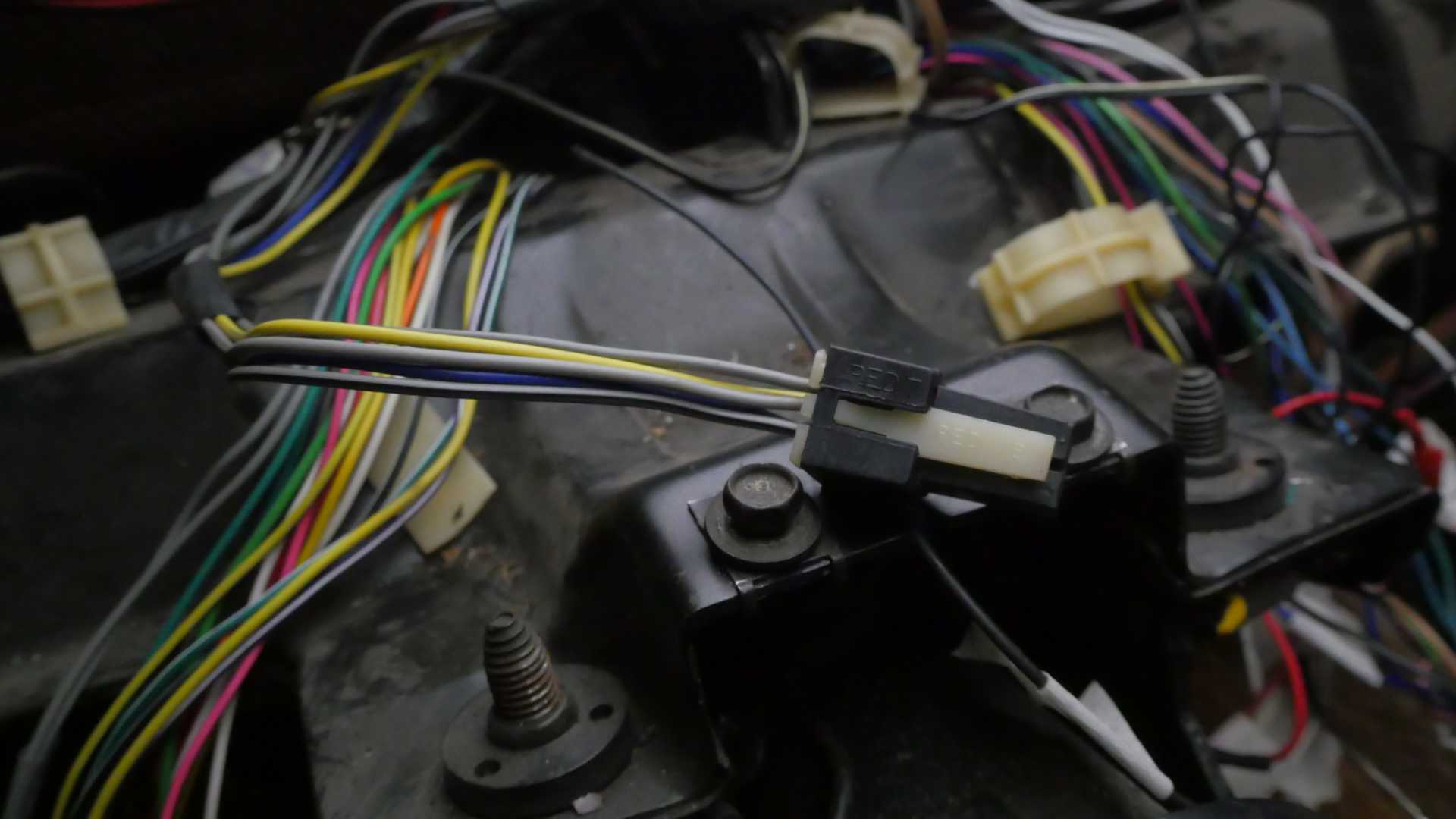

| What connector is this? Left of dash cluster (Page 1/1) |
Fie Ro
FEB 05, 01:06 PM
Yes I searched!!
I can't seem to find where this goes or if it was even connected before (I tend to think not). But I want to know what it is. It is bundled with 2 wires from the clutch start switch and that bundle runs to the midconsole behind and under the radio. I can't trace it further nor can I find it anywhere in diagrams. I checked if it could go to: -cluster -cruise control -subwoofer control -whaterver this could plug into So far no succes.
These are the markings on this (square) connector: A=yellow B=grey (2 wires) C=grey/black stripe D=dark blue
FEB 05, 02:57 PM
That is the plug the cruise control stalk plugs into.
It goes under the dash on the left side of the column.
Fie Ro
FEB 05, 03:11 PM
It goes under the dash on the left side of the column. |
Ah ok, thanks! I think I left it disconnected when I replaced the steeringcolumn several years ago. Cruise control was already removed from the enginebay.
